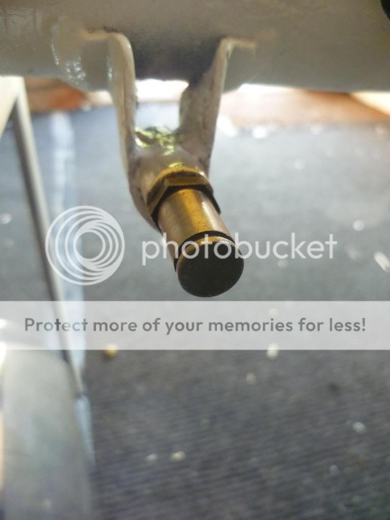

Followed his tip for using rear brake shoe pivot to replace rear brake pedal peg and it worked a treat and looks good into the bargin. Had a lot of slop and hardly any circlip groove left on the old one. Only issue is the new brass bush i have wont quite fit over. Should be okay with a plastic one though.

jason frost wrote::lol: I think that was me ;)
as in your input into the book?
Good work fella
Speed Demon
Posts: 392
Yes, it was Jason who gave us that top tip for the book. Glad it worked for you though.
