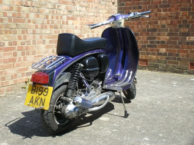

The GP's had abit of attention recently and now i dont know if i could handle the stress of my lad learning to ride on it :shock:
Ive recabled it, new loom coil and reg, rebuilt the forks with MB progressive springs, mid range tank and fast flow tap, snetterton seat

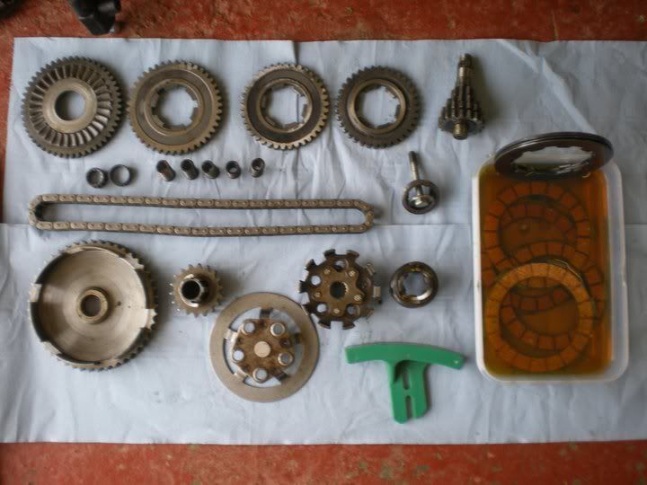

The 150 gear box has been junked in favour of a GP200 item , new bearings, new clutch and MB uprated springs, new chain, sprockets n tentioner, LTH reedvalve and ram air filter for the 30mm Delly
Ive played around with different sprocket combinations and have settled for the time being on 17/46
Over the winter, the Mugello top ends going off the Mr Broadhurst for one of his reedvalve conversions and abit of a tune then i'll probably revert back to the 18/47 set up

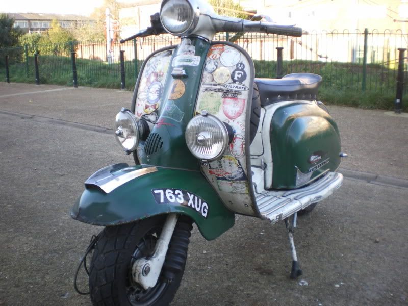

Stinky Finga
Posts: 67
Location: Heathrow
A few things ive noticed between the two is that the S2 seems more planted on the road and for a bigger scoot it actually feels lighter :freak:
