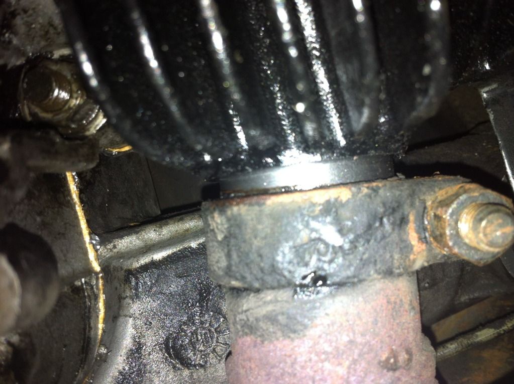

hi will this be ok its a leo vinci exhaust onto a dr180 kit
doesnt matter how hard i try it will not go on any further it is nice and tight and got silicone in the joint anyone help

it will be ok, but i"d sand the inside of the down pipe , and the barrel stub, and loosen the main bolt on the casing, then try again. no such thing as "can"t". LEOvince pipes were ok, but you cant get them anymore for some reason. i ran a leovince on a DR 180 kit years ago, went well.

Check for any spot welds on the down tube and clean all the carbon out as well with a small wire brush or a grinding bit on your drill.
If it was me, I would cut the clamp off and use a 'U' clamp. PM with your email if you want a picture of it.

yea but if you dont no what your doing with a CAR u clamp you will fuk it up big time be that i mean all flat..... :cry: drill 2 little holes in ur barrol fins and get 2 good strong springs :baddevil:
