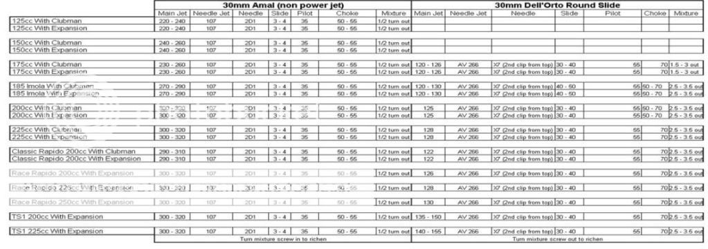

I have been running a GP TS1 225 with a BS sterling pipe, 30mm dellorto carb PHBL for about 2 years now with no problems, I have just fitted a Franspeed pipe and went for a ride and it seemed fine. I then got home and stripped the carb as it had a lot of crap on it, but I didn't mark how the mixture screw and slide stop screw(tick over) were set. I have been fiddling with them but it doesn't feel the same and I am having to rev the b@11@x off it to get anywhere! Does anybody know how many turns the screws should be set at? Also any advise on jetting would be appreciated?
30mm Dellorto PHBL Jet settings are -
AV266
135 Main
40 Slide
55 Pilot
X7 top clip

don't know if this helps you or not,its off the old AF Rayspeed site or failing that theres bound to be something similar in here
http://scooterotica.org/forum/viewtopic.php?f=9&t=14

Anyone got a link to that spreadsheet the one on their site now doesn't work.

cheers was looking for this jetting table but its not on the new AF website
Many thanx
