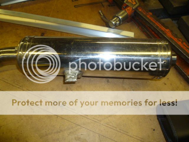

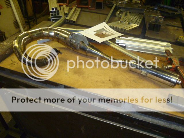

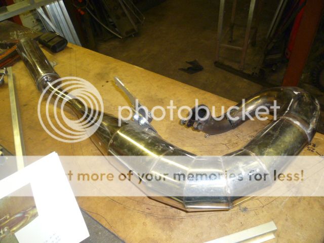

Okay, finaly got some pics. Anyone identify this pipe and know where I can get a stub that fits?
Ta

Isn't that a Scorpion pipe? my mate Tavspeed on here has/had one and could confirm.
Yanker
Posts: 576
mawso wrote:Isn't that a Scorpion pipe? my mate Tavspeed on here has/had one and could confirm.

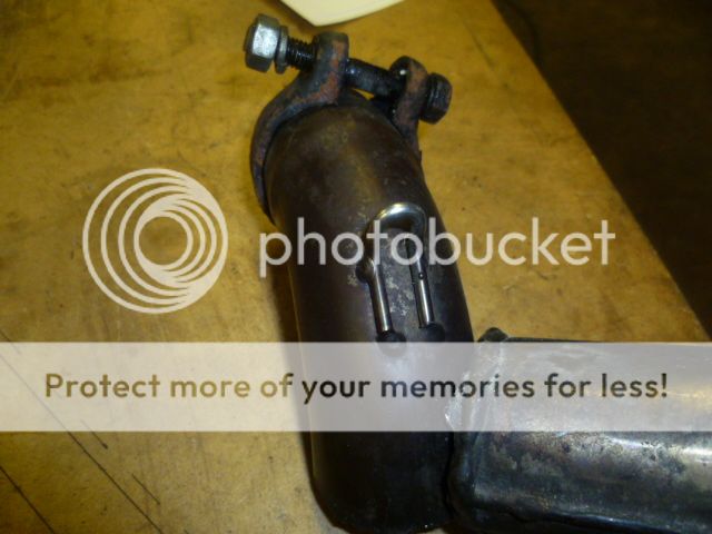

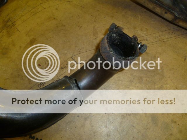

Looks like a Scorpion to me too. Is the broken stub just blackened with heat/oil or has someone tried to weld a mild steel downpipe to the broken Scorp? The clamp is out of place either way: Scorpions have a stub/slip-joint.
Thet do snap 'readily' 1/2 a Scorpion pipe danced off the road and twatted my leggies then arm on the way to a rally (rider in front). Stainless 2 stroke expansions with two mounting points :-/
Scorpion did (or do?) stubs. There were 2 versions 'single' and 'double' slip-joint so beware.

Yip its a Scorpion - i have one hung up in the garage
before you ask sorry but its for a mates bike
the clamp may have been an attempt to seal the stub to the pipe - the one i have is a single skin stub
i dont think they dont make them anymore for lambretta so it will have to be ebay or forums
best of luck

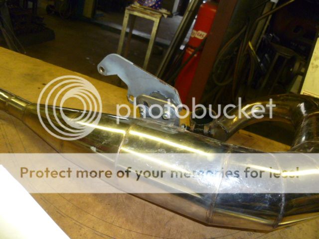

Cheers lads, so it looks as though its a scorpion. Can anyone confirm wether the bracket at the end is an addition or part of the pipe. Im hoping he still has the stub, hes looking at the mo. What sort of pipe is it, tourer or revvy? Its going on a standard 150.

the bracket on the tail pipe is two pieces - one on the tail pipe itself then a seperate bolted together with a rubber bobbin that fits on the shocker mount
i`ll take a photo tonight and post
