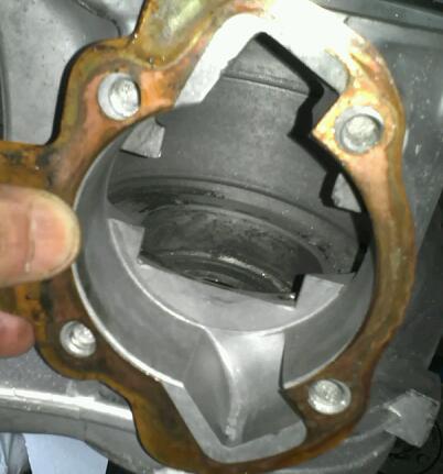

Having. never matched a casing to a barrell thought Id ask the rotica peops if its easy done and wot tools are involved. wot your looking at is a LI150 casing and an imola 186 gasket....alot to come out ?

will watch this with interest as Im building a mugello kit this week.
to match it will leave next to no wall on my kit :(

which is why certain (if not practically all) imola kits need the casings welded up if you truly want to match the ports.
