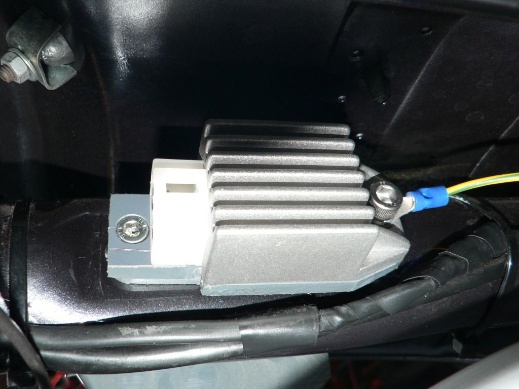

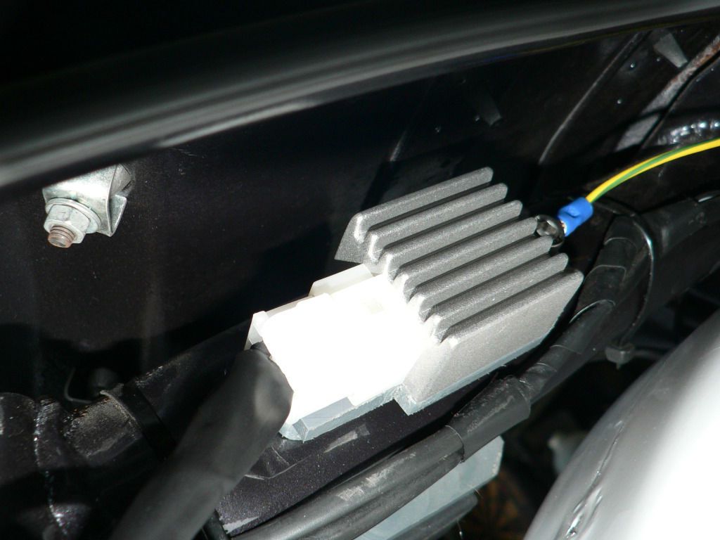

One of my new Christmas pressies was a new BGM regulator/rectifier and I thought the connector looked a bit familiar.

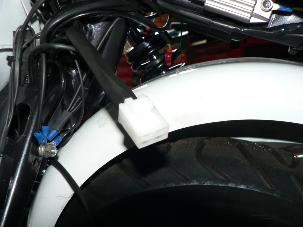

Although they supply individual wires and spade connectors with the regulator, I thought it would be a bit neater if I used a "proper" plug.
I was able to source one easily from my local electronics store and now have a neater installation!
The additional advantage is that if you have to disconnect at any stage, when you plug back in there is no chance of getting the wires on the wrong connectors.

That's great until you need to pull off the stator plate and need to unpick the plug!
Minority
Posts: 673
Main scooter: Li230 S3
Dryballs wrote:That's great until you need to pull off the stator plate and need to unpick the plug!
Ooops :oops:. Good point!
Hope I don't need to take it off too soon. :lol:
But you can get an extracter tool to take the terminals out of the plug (and a thin paperclip usually works :lol: )
