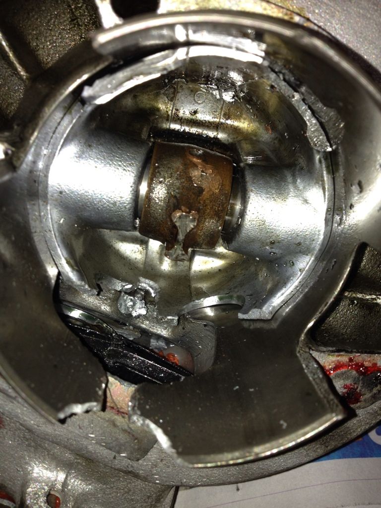

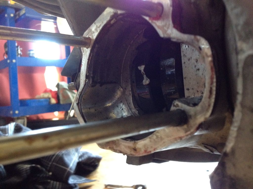

This what happened yesterday to my monza 225 setup the crank was a mec 60mm with 107 rod since a whole new topend is needed do I chance using a another mec crank or go for some stronger like a bgm hpc crank???
What do people recommend???[imgImage][/img]

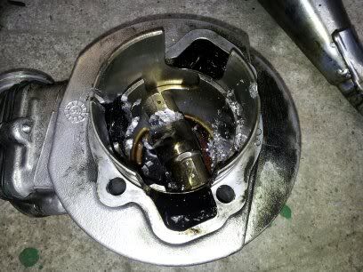

Same thing happend to me mate comeing back from whitby this year on my ts1, first thing glad you dint come off,had the crank rebuilt at chiselspeed fitted a rb con rod and little end bearing my barrel was mb tuned sent this off to lancourts and got repaired so that is a option.best of luck with the rebuild mate
one more thing what speed were you doing cheers rob

It happened in 2nd gear I had just turned a corner in the cbd so I was only doing about 30km p/h heard a ping so I put it in neutral and pulled over.
Barrel piston and reed block are bin jobs I'm not sure if I could trust the crank if it's repairable though
