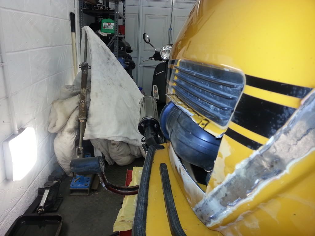

Hi,got an LTH filter fitted to my mikuni 35mm with an mb inlet and this is how far it sticks out.
WINTERMODEL150 wrote:Hi,got an LTH filter fitted to my mikuni 35mm with an mb inlet and this is how far it sticks out.
Looks good, got any finished pics Dean?
