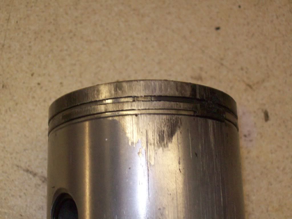

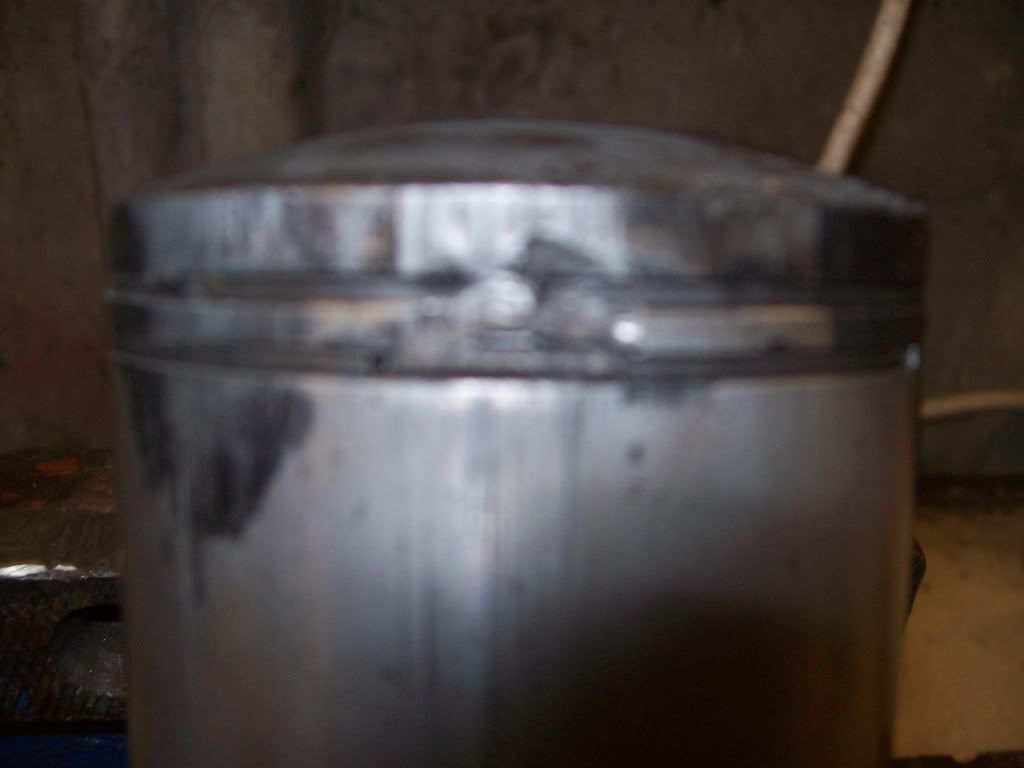

well after another piston and rings 150 miles later same thing happens again
looks like the rings are snagging on the exhaust port,was going to pick my lad up
after work,lost power at 50mph revs climbed grabbed clutch leaver and rang a very nice man
to pick up..

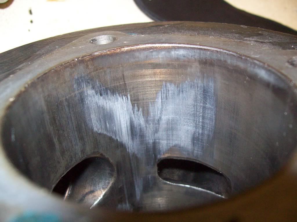

What is the engine specification? Carb, pipe, airbox or open etc? The exhaust does not look wide enough to be a problem but the condition of the bore does not look great. By this I am not talking about the seize mark, I am talking about the lack of a cross hatch hone marks. Has this barrel been properly honed true? What is the history of the barrel?
The exhaust port looks like it's the right shape but it does look like there's some 'squaring' at the top of the port consistent with the rings snagging. Is it possible that the rings got stuck in their grooves due to an earlier seizure thus not allowing the rings to fully spring back? Just thinking aloud 8-)

at mo running a stage 4 top end,rd rod,2.5mm packer,expansion pipe,30mm delly through panel,sean tuned just under 15bhp, this barrel has done approx 1700miles,1st time summit happened was crap base gasket some people reported on here,hone 1,then the next time piston ring pin came out and snagged the exhaust port thats what the nics are on the photo,hone 2 and now this has happend
and yes the piston is in the right way :) i ride in all weathers to and from work but this is getting me down.

To be honest I'd check the hone, It should have a cross hatch pattern in it even after 1700 miles. Secondly, and this is by far more probable, see if you can check the concentricity of the bore to the base gasket.
I got given a cylinder to sort out once. On inspection the bore was not square to the cylinder so the piston would have greatly reduced clearances top and bottom. The clue was looking at the chamfer on the skirt of the barrel, it was not even around its circumference. Worth a look I think, but I'd get that bore checked at several points for ovality up and down the bore.
given that there is a definite line to the seize marks in first pic i think rich is correct
