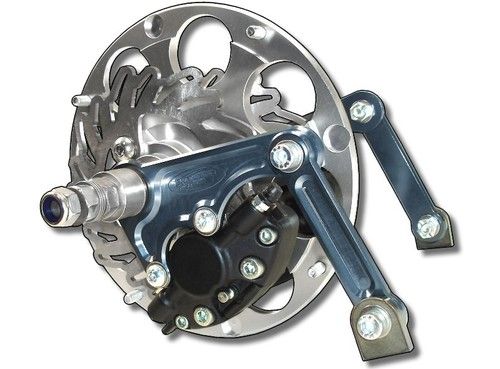

Hi I'm thinking of buying the PM Tuning Twin Disc Anti Dive Drum and Disc Link Conversion, for my Lambretta.
[imgImage][/img]
link here
http://www.pmtuning.co.uk/pm-tuning-twi ... -lambretta
Have any of you guys got this fitted to your bikes?
My questions are
How easy is it to fit?
I prosume there is some welding involved?

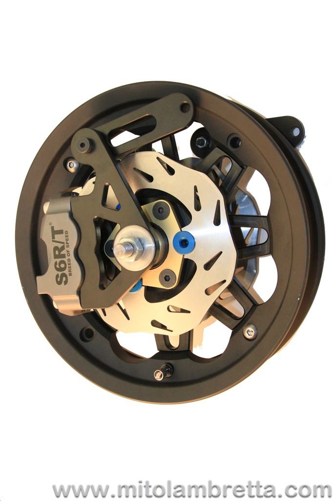

http://www.mitolambretta.com/product_in ... cts_id=204.
Have a look at this double disc it's the dogs b@11@x

Very nice not seen them before, have they just come out? I'm liking the look of these a lot better than the PM ones, at the bottom of the page it says to contact AF Rayspeed for supply in the UK. Just been on there web site and it dose'nt mention these at all?

you will need to weld on the anti dive brackets and you will need the reversed links also i believe
niz wrote:Very nice not seen them before, have they just come out?
yes .. id have one in a shot
one thing you need to be aware of with the mito set up and i guess it will be the same for the pm one .. Francesco Collodello who i belive did the race testing told me that the master cylinder needs to be able to shift a lot more fluid than say a scoot rs type and he used a radial type m/c .. there should be a link to that on the mito page
something like this -
