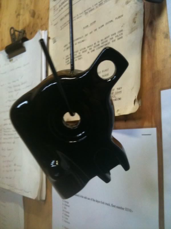

I had the pickup bracket welded to speedo housing like this. I replaced the bolts that hold the disc on with magnetic ones
can you post a pic of the magnet and pick up ??

That was Pride/mark that did that. He glued magnet into worm on hub and then the pick up where speedo cable goes. I can't remember if he ran pick up wire inside normal cable to give standard impression
