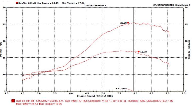

TS1 225 - 25.4hp

This is my special - Dynoed yesterday
JB tuned TS1 with MB piston
58 x 107 race crank
Boyesen Yamaha reed
Ignitech ignition
Italian GP200 gearbox
AF race clutch
PM fat Mamba exhaust
Mikuni TMX32 carb
DB.pdf
(171.8 KiB) Downloaded 2145 times
pretty picture
