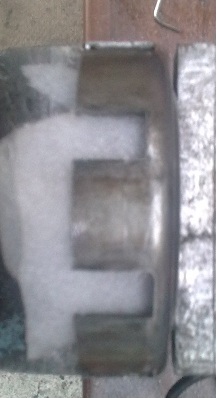

on a couple of those dragging cosa threads threads, there was mention of a photo of the basket mod.
here's mine ~
not a great pic i know, but you can see the difference between the enlarged slot and the one above it yet to be done

When you do the lower the basket cut outs job do you use a diamond file?
cit205 wrote:When you do the lower the basket cut outs job do you use a diamond file?
dremel with my favourite diamond bit, then selection of proper hard-as-feck old english files from my engineer father-in-law. It was softer than a Lambretta basket.
