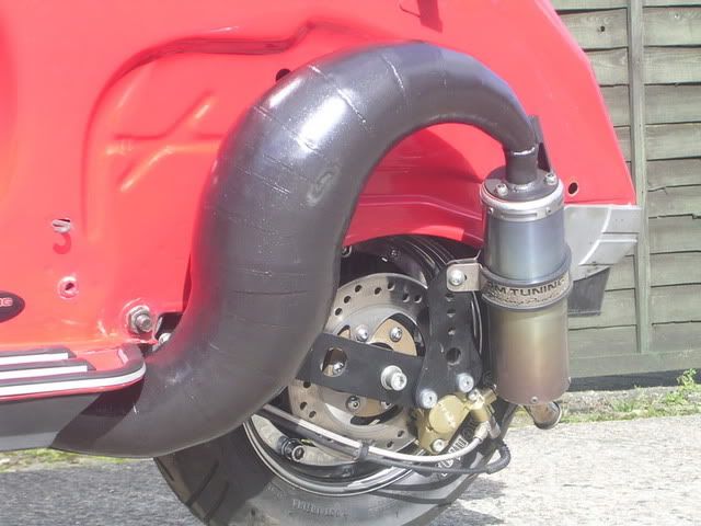

OzOAP
Posts: 306
Main scooter: Vespa PTS1E
Got SIP outboard disc set-up on my TS1.
Had it about 7 years.
Disc didn't run true when I got it, so had to modify it slightly on lathe.
Had no problems since.
Running a SIP pedal with a 12mm bore cylinder (unknown origin). Brake light is of a hydraulic switch in place on banjo bolt on caliper.
