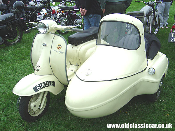

Yes i thought someone was remaking them ?
youd be better off with one of these though
http://www.oldclassiccar.co.uk/photos-cars4/33.jpg :D
