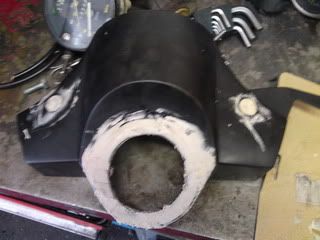

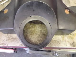

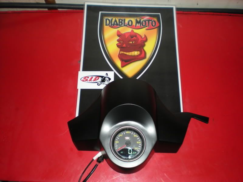

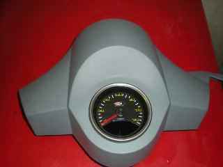

Heres some pictures of my headset modified to take the speedo and then wired to a car battery to show the display.........
I think you'll agree apart from my rather slapdash finishing it does look sexual. I'll have both working next week so will report back then on how I've got on.
