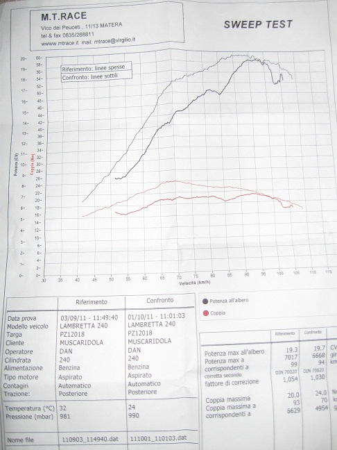

i've got one. It pulls really well, better than my Gori 50mm.
I've dynoed them both and the mito pipe is better in torque with the same hp.
Currently i've got a race tour 240 (71x60) vhsh 30 mm carb and sx200 gearbox with 17x46.....the mito pipe pulls this box easily in all condition.
