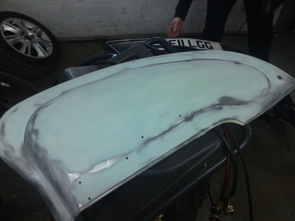

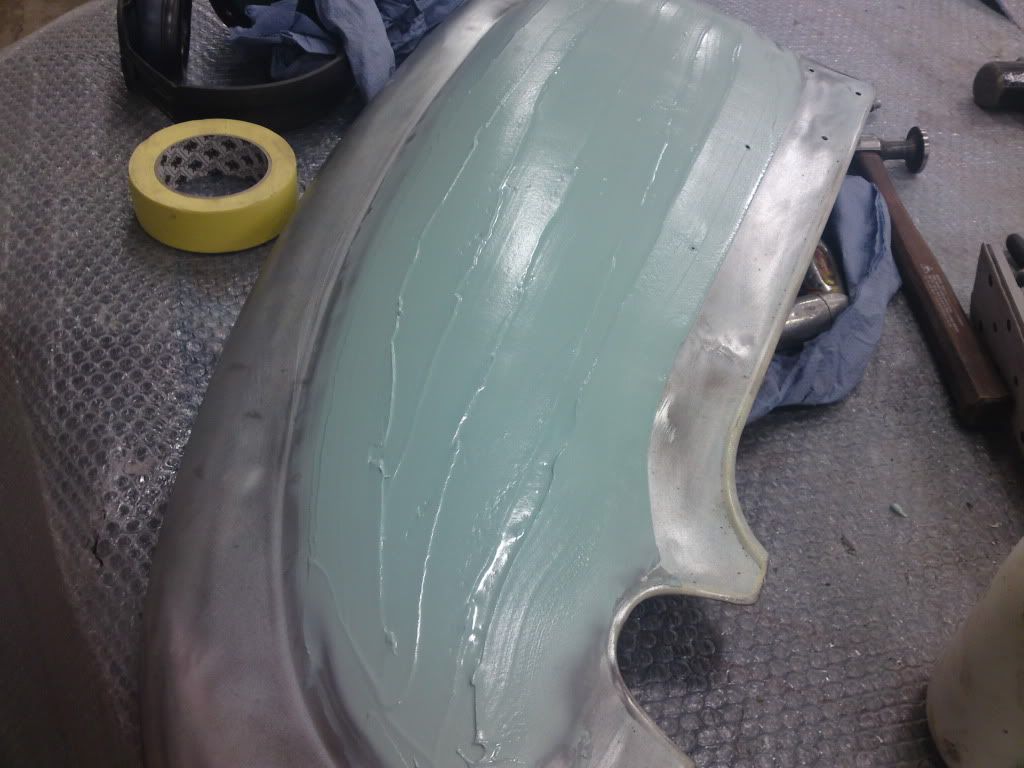

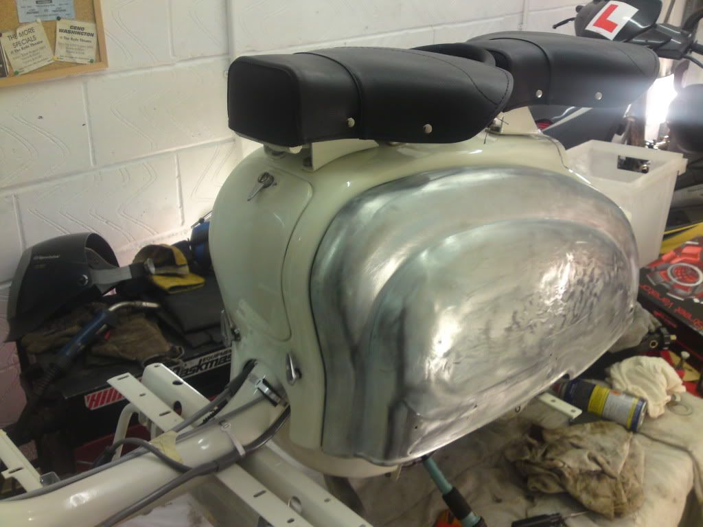

Always try the panels on with the body curve rubber and handles to make sure they fit correctly,never fit the rear leg buffers and try to skim on the bike as you'll be chasing the high spots that the buffers causes for ever more.
Here are some i did recently as explained above.
