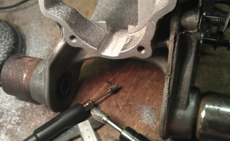

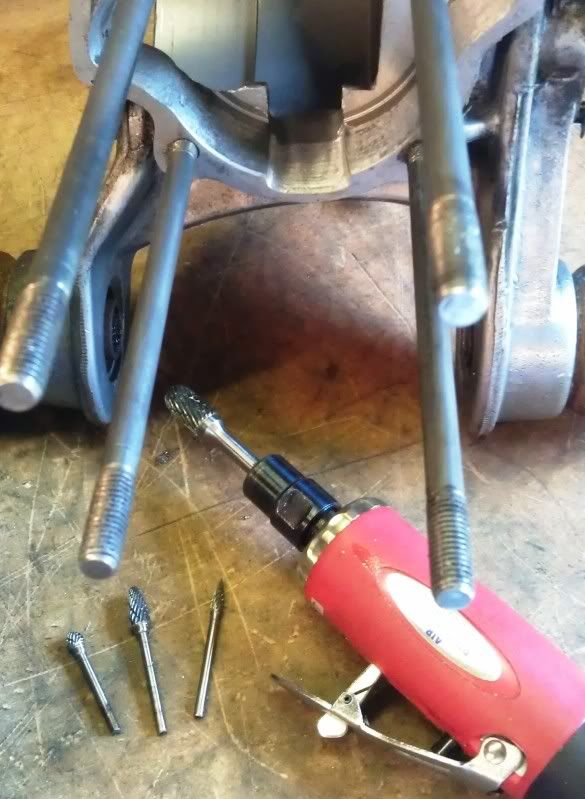

Casings having extra transfer channel cut in:
Cut an inlet opening into bottom of reed area to match new transfer in casings, also reworked transfer ports on cylinder:
Underside of new transfer, and re-worked exhaust port:

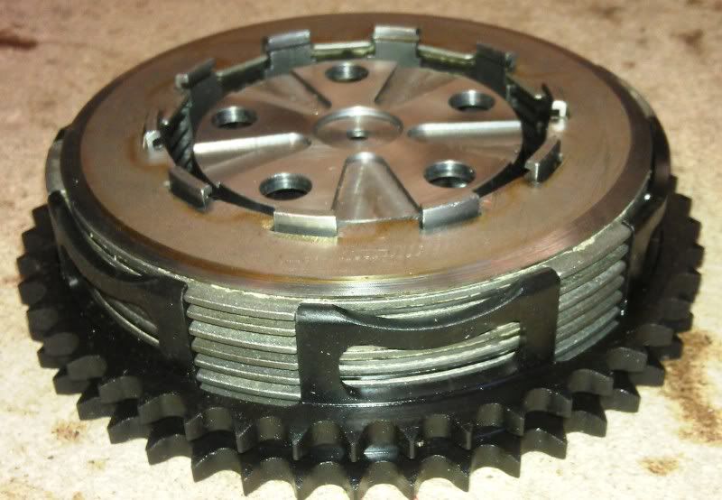

Now just working on a 7 plate clutch for the same engine:
As soon as clutch is finalised will rebuild and pass engine back. When it comes in for a dyno will post graph.

How are the ring peg positions with the extra inlet work.
Very nice work indeed.
Chris CSPE wrote:How are the ring peg positions with the extra inlet work.
As you'll be aware, the bottom ring of the MB piston presents issues on that side with its peg position, but i came up with a suitable solution.
