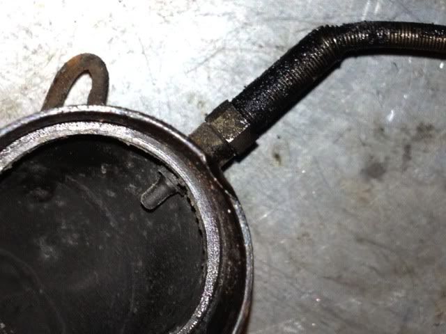

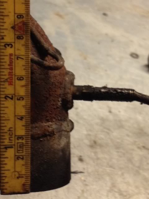

My RB 25 have "melted" twice. Even the sparkplug have melted. Thats not the case in this tread.
My koso exhaust meter have never shown much more than 400 degres C. So I have done somthing rong.
Any tip?
Cheers
Stian
[imghttp://i1145.photobucket.com/albums/o502/saabstian/eksos2.jpg][/img

that probe looks to short to me, the tip i thought is meant to be in the middle , my koso shows egt at about 630c and think it is safe to go up to about 700c , melting point if i rember correct is about 730 ? cht stays at around 160-190 c this is also on a rb
The probe should be 100mm from the piston skirt, that looks as if it needs to be moved down the pip about another 25mm or so

Your probe should be nearly in the middle of the pipe.
