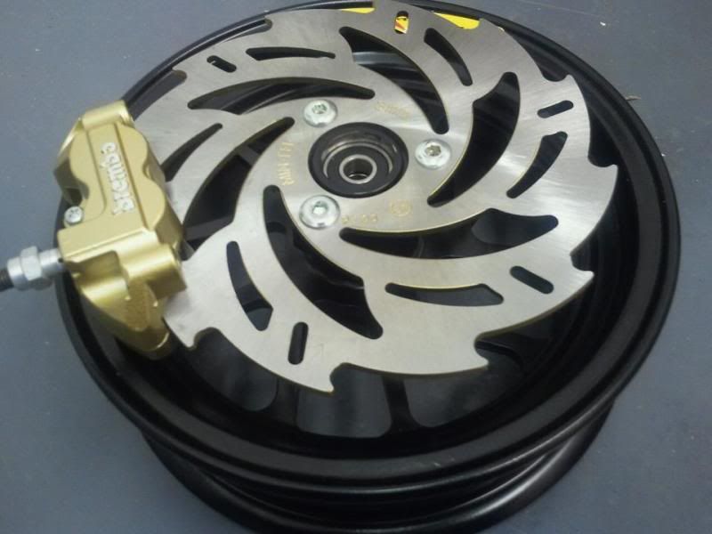

nope, lambretta GP forks
making my own links for the wheel etc,
wheels are monkey bike, alloy ones. 220mm front disc and 150mm rear disc
this is my front wheel,

tonydevon wrote:nope, lambretta GP forks
Excellent Tony 8-) Have you made working drawings of them as yet ?
