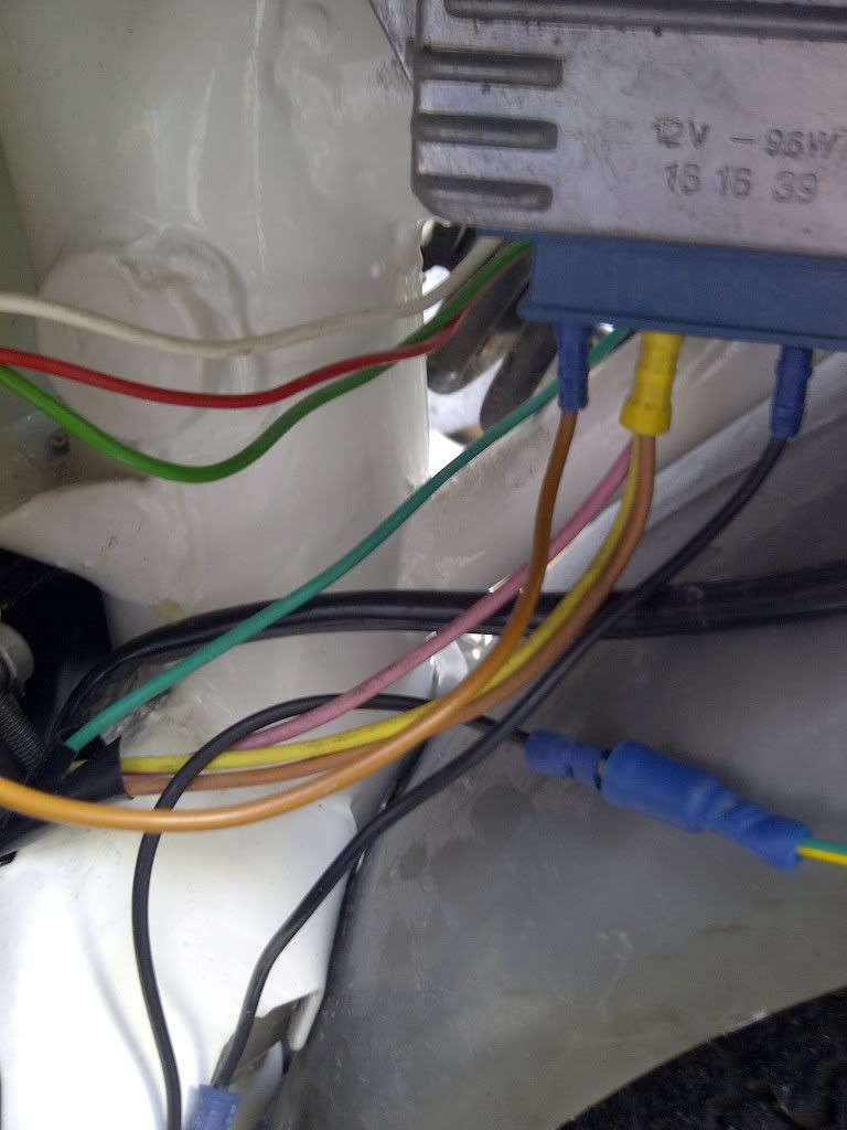

right ok, heres what we have -
From the regulator - brown (left) yellow,pink and brown all shoved into one (middle) that doesn't seem correct, then lastly black earth (right)
the cdi - white red green green

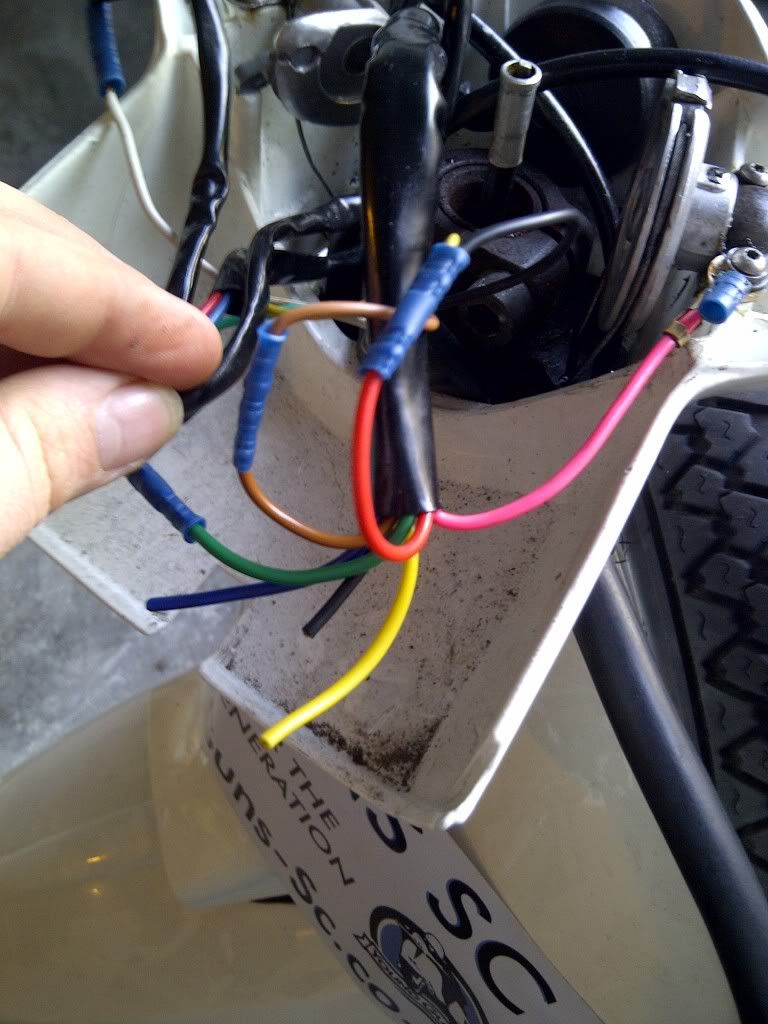

the head set top loom - don't know whats happened hear, i have a pink earthed, red connecting to a yellow, this is where i think the problem is
wack 63
Posts: 1254
Main scooter: '71 GP TS1
Location: Lincs
Unfortunately I can't see the loom into the headset but if the same wires are present as at the regulator then you have 3 lives when you only need the one brown.Connect this brown to the key switch brown and blue,yellow keyswitch to pilot bulb,pink to earth,switch black to loom (which ever runs to rear light,keyswitch red to dip/high yellow.I need to know where the loom yellow and purple are going.

wack 63 wrote:Unfortunately I can't see the loom into the headset but if the same wires are present as at the regulator then you have 3 lives when you only need the one brown.Connect this brown to the key switch brown and blue,yellow keyswitch to pilot bulb,pink to earth,switch black to loom (which ever runs to rear light,keyswitch red to dip/high yellow.I need to know where the loom yellow and purple are going.
the ignition loom seems to have blue instead of purple and red instead of orange,
i have managed to suss it out now, i have removed the yellow and pink stuck in with the second brown at the regulator,
who ever wired this up was a moron as he didn't put any bullet connectors on the end of the wires, instead just clamped them together, instead of connecting them to the switch box on the headlamp,
i found the pink one was connected to the horn and the yellow one connected to the brake light switch, so i have removed these and i have wired it up correctly now,
so its all sorted!! thanks for the help
