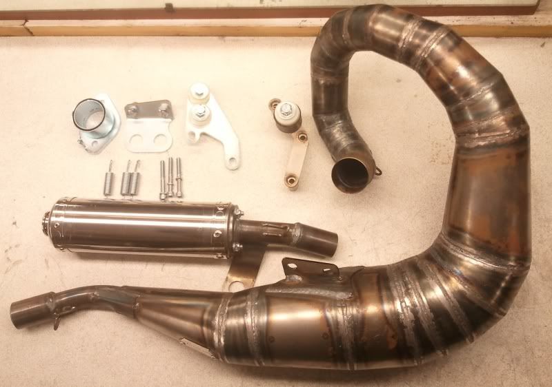

The pipe itself looks very well made, has rear silencer supports, and it sounds pretty trick to boot. We intend to put the pipe on just about every machine we can find to run up on the dyno, and test it against every possible other pipe we can gather or get our hands on. So this week when we got Andys 200cc cast iron stage 4 tune in to upgrade to the Avanti kit, we started the ongoing process. We had my own ADS fast road pipe to hand (for my TS1) and Andys scooter had a PM25 fitted....so the first 3 pipes were set to be tested on Andys scooter, here's how it went.

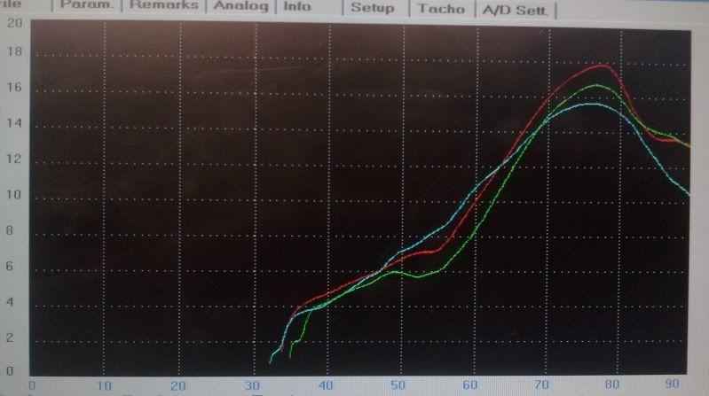

Andys own pipe (PM25) is shown in blue @ 15.57bhp, then in green in the ADS fast road @ 16.75 and lastly in red is the Franspeed Race at 18bhp. You can see the PM25 actually out-performs the ADS fast road on this engine below 7000rpm and only loses out 1bhp at peak, so in this engines case, the PM would actually be a better pipe choice than the ADS fast road. However, when you look at the Franspeed, you can see the mid-range losses are actually minimal, and the top end gains are more substantial...it has nearly identical mid range to the PM and nearly 2.5bhp at peak.....not bad!

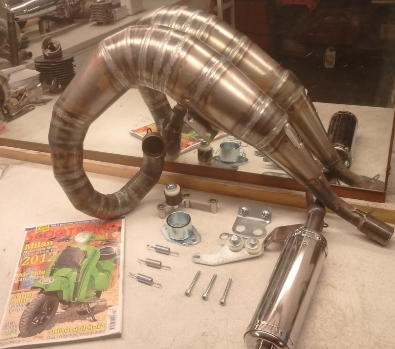

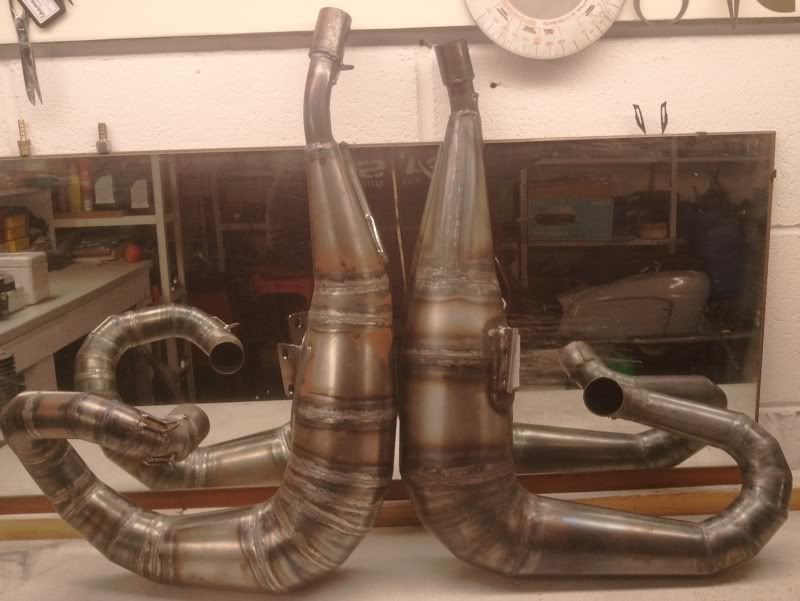

Franspeed visual compared to ADS:
Franspeed left, ADS right.

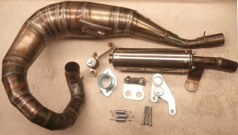

Franspeed and Avanti:

Are them figures with my head blowing on the stage 4 as well Dan..??
bazman
Posts: 578
Location: Annan S.W. Scotland
As i keep telling people .....lol, massive difference to my stock ts1 ( albeit 60mm crank) over the franspeed tourer and no real loss in low down tourque, BUT with the ability to rev on means a very fun scoot.
Lam46 wrote:Are them figures with my head blowing on the stage 4 as well Dan..??
yes
:wtf: so it had lost 2 bhp with the leaky head running the PM that we know....so in theory with the head re nipped down it should give 20 bhp with the franspeed race on :?: ..(my stage 4 top end that is)
