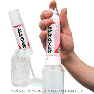

If you are worried about rust you can use an epoxy matte black or epoxy primer with rattle can flat over it. A true epoxy uses a hardener so you wont find it in a spray can. You can, however, buy the paint, mix it, then use a Preval sprayer. It essentially turns any paint into a rattle can. I use these all the time and they work as well or better than a moderately priced spray gun. Plus you get ten times the amount of solids you get from a can of Krylon by using real automotive paint:
http://shop.preval.com/collections/fron ... al-sprayer
Please take precautions when spraying paint. Modern catalyzed paint can be deadly.
