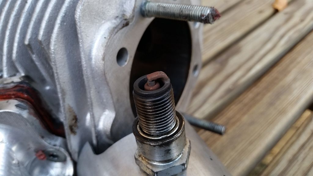

First thing when I got back home was to check the plug. As you can see below, its a great color, which confirms the jetting was OK. Last weekend, I stripped the top end, but before going too far, did an air leak test using the Grandpa and Coaster inner tube test and confirmed no leaks.

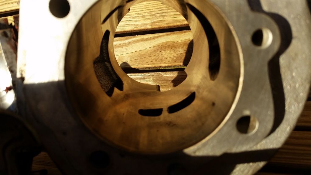

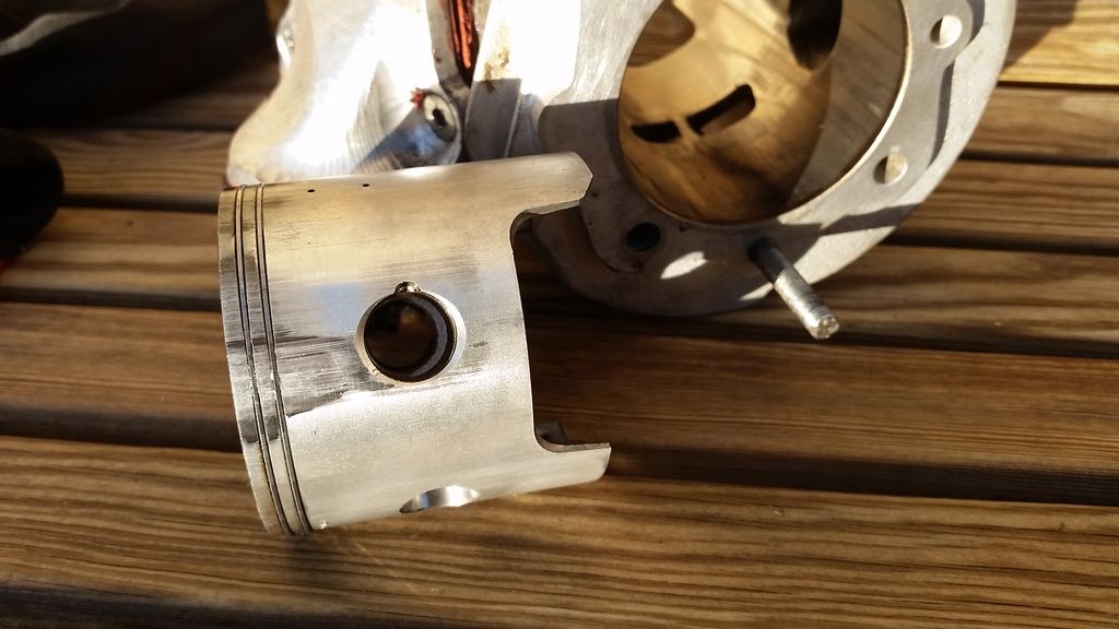

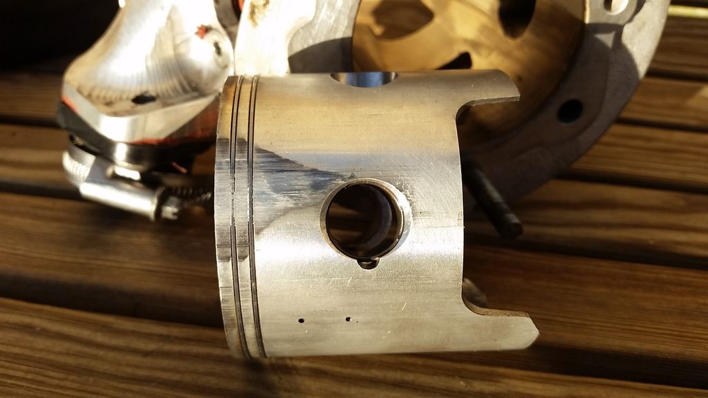

As you can see from the photos below, it was a type of heat seize to either side of the conrod and opposite the transfer ports. The rings were locked in at these two pints. Fortunately, the lining is still intact in the barrel and the smear on the piston is just that and has cleaned up well enough to re-use. Will re-build this weekend with new rings and new small end bearing, but am concerned that it may happen again.
However, when doing the initial top end re-build, I forgot to check the ring gap. Just done that this morning, with the old rings and getting around 0.15mm, which is way too small. So my thoughts are, ring gap too small, is the main reason.

With the seize lining up perfectly with the transfers could you suggest that at full throttle the transfer stream is what is actually keeping the piston cool and preventing seizure (or detonation)?
As you then shut off the piston is no longer cooled by the mixture flow and causes the seize.
This is information gleaned from Frits Overmars and the Aprilia project where he confidently stated he would run full throttle for 6 hours with no chance of a seize but the bike would seize within seconds when going to 20% throttle or below.
None of this is easy to replicate on a "normal" dyno as you simply go up and down the gears/ rev change in most cases therefore you get a false sense of what is happening. You never hold the bike at full throttle (with a load on like Eden says) for 30 minutes so its impossible to replicate.

Could that piston be dodgy? Machined incorrectly? i.e not as elliptical as it should be. Might be interesting to throw a micrometer across it. :ugeek:

Plug also looks in the pic to be glazed which indicates the motor suddenly got hot melting the normal deposits.
An 8 plug in a tuned motor is ok for normal riding but for fast running a 9 or 10 would have ran cooler.
I always use at least a 9 and always a 10 for long motorway stints.
