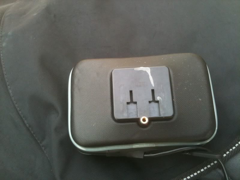

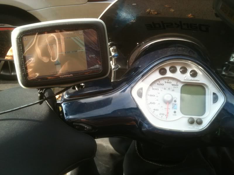

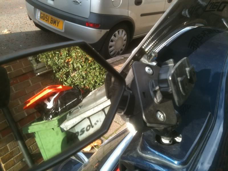

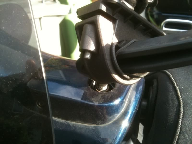

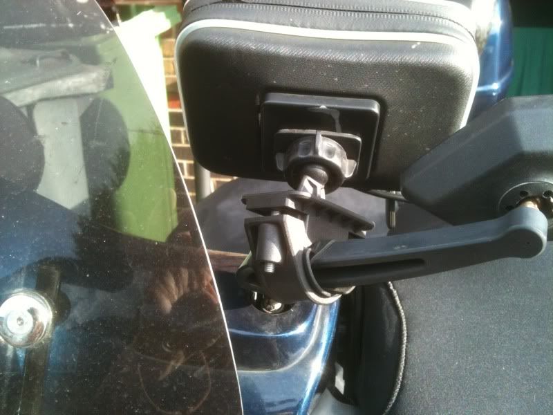

As you cab see, the Garmin Nuvi is listed as one of the models that will fit. As for scooter attachment, the case clips onto a bracket that is designed to clamp round a set of handle bars so strictly speaking, they aren't designed for scooters, even the £400 motorbike ones aren't However, with some inginuity it is possible to find a way of mounting the clip. see pics below of the way I fitted the one on my Vespa GTS (on mirror arm) but I won't get a chance to take a picture of the lambretta solution until the weekend. Basically though, I took the clamp apart and bolted the top part with the clip onto a small piece of bent ally which I then attached to the top of the legshield toolbox.

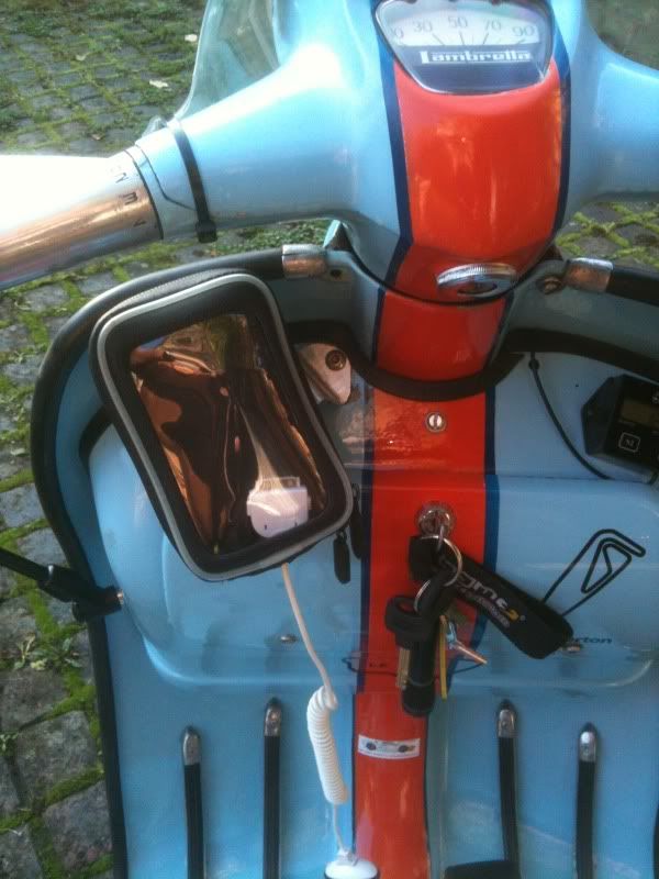

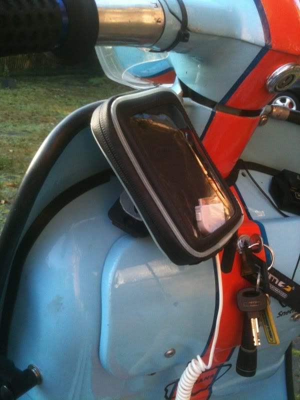

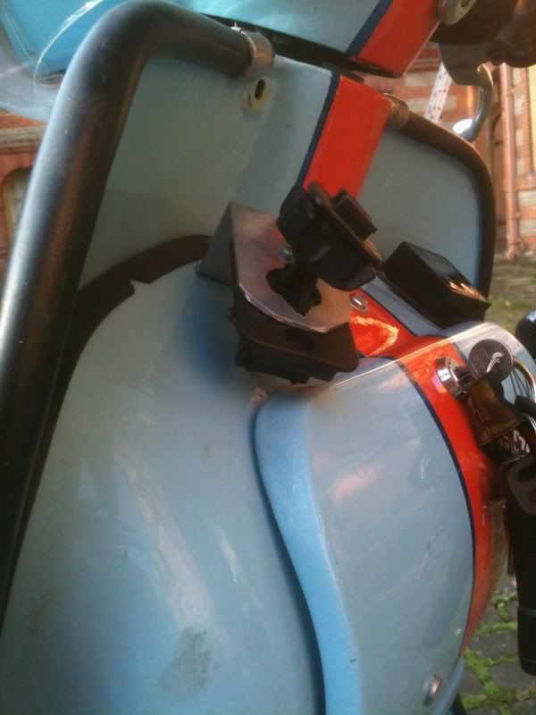

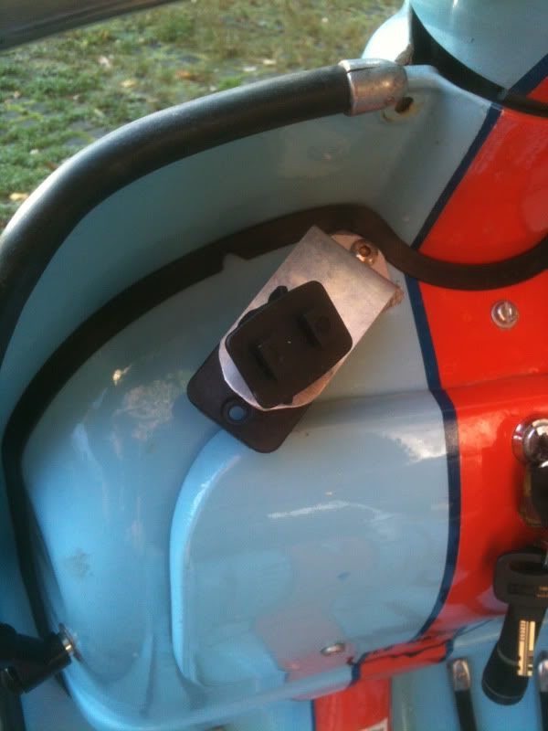

As promised, here's some pics of the same type of mount (just the top part) screwed to a simple ally bracket mounted on top of my legshield toolbox. I will probably make another one and fix it to the 2 throttle support screws.
