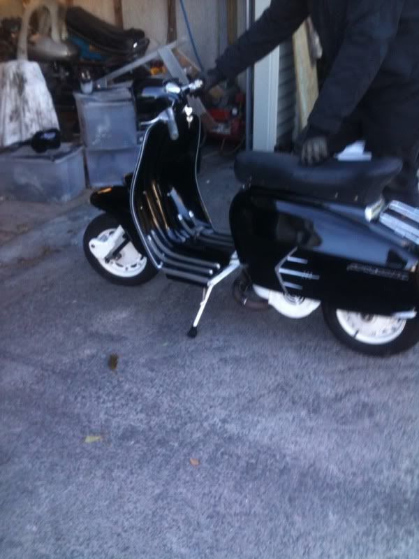

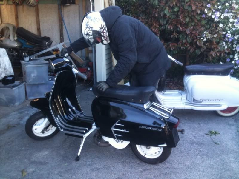

I finally got it going!

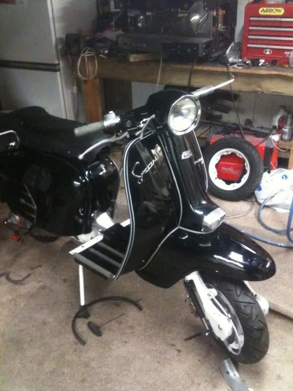

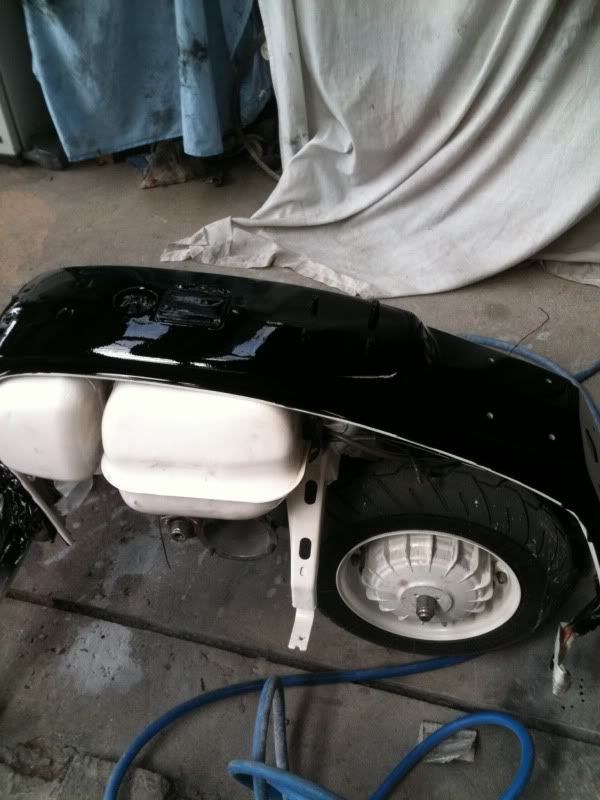

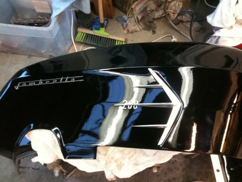

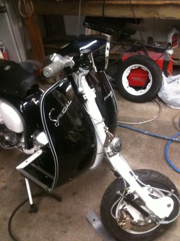

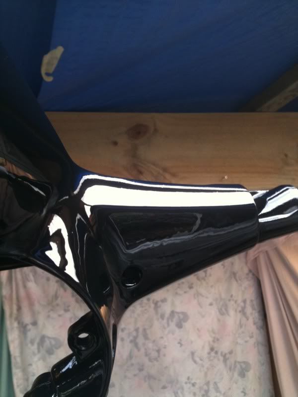

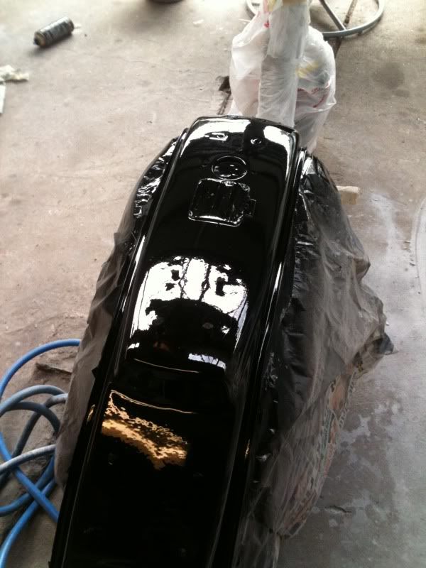

After cracking my frame last year, I rebuilt and repainted my Series 3 this year... It was also my first attempt at painting with anything but a spray can!
It wasnt very nice to ride as both tyres were flat, but it was still fun!
Anyway, here are the pics...

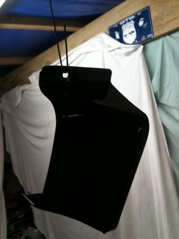

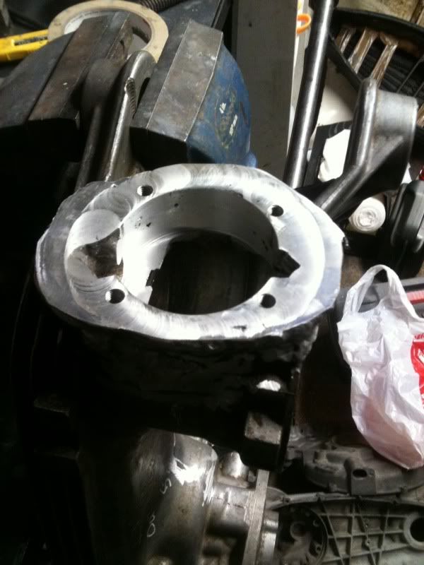

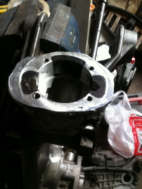

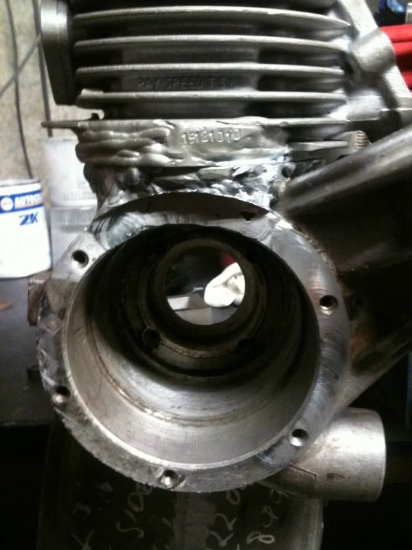

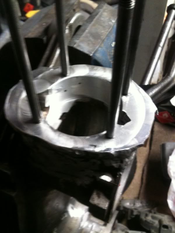

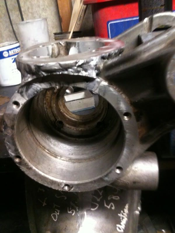

LI125 case after some welding and machining

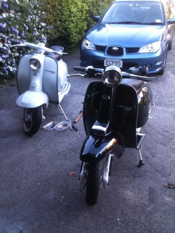

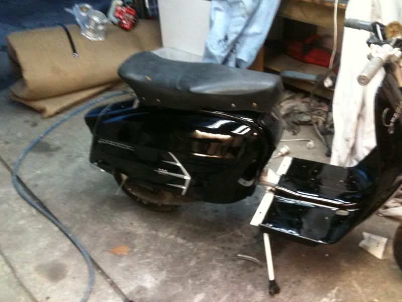

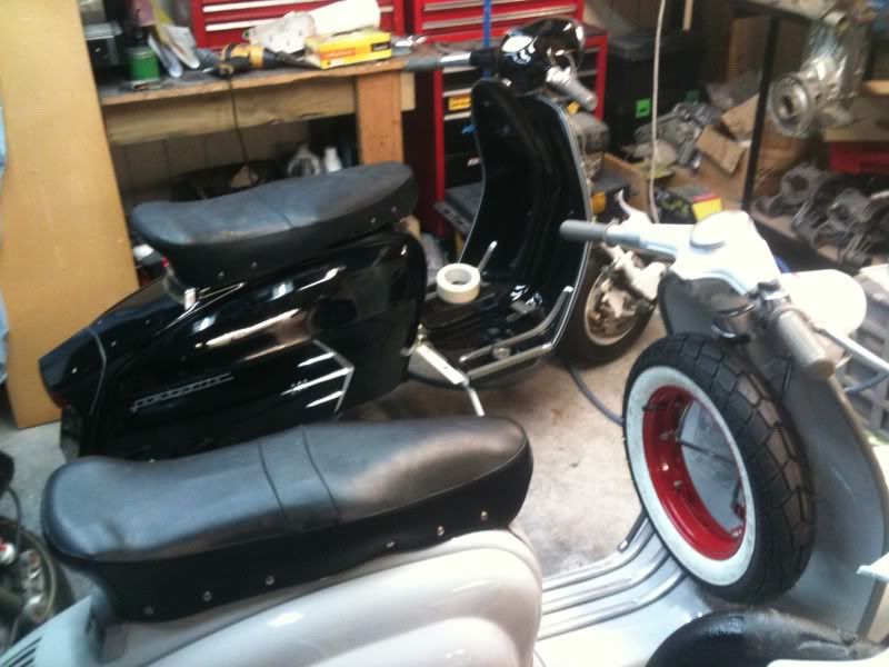

This afternoon!

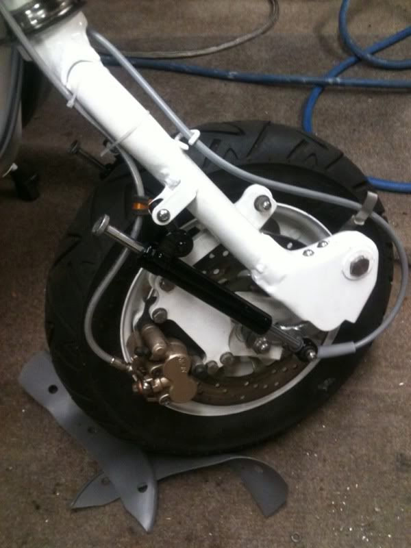

Just in case anyone forgot... this was why it was taken off the road
Specs of the engine are:
Ts1 tuned by John Balcomb with Super Monza piston, extra big ports and an extra boost port. 61mm crank with 115 Yamaha rod, TMX carb, PM28 pipe, Original AF flywheel with BGM stator.
All this is built on an Li125 case which I had welded, machined and bored at a local engineers here in New Zealand.
The paint isnt too mint, its a bit orange peely in places, but it was cheap! and I learnt heaps along the way

Very shiny. Asian?
Dryballs
Posts: 333
Location: Stockwell, London
Muttley McLadd wrote:Very shiny. Asian?
Good spotting! I did get those side panels from "the scooter rebublic" or TSRvn on here
They were mint too

It doesnt go so good just yet, I need to dial the carb in alot!
It'll come tho... expecially since my Series 1 shat its varitronic on the weekend
