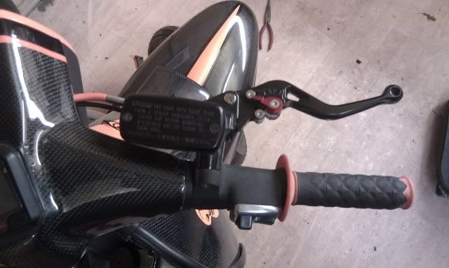

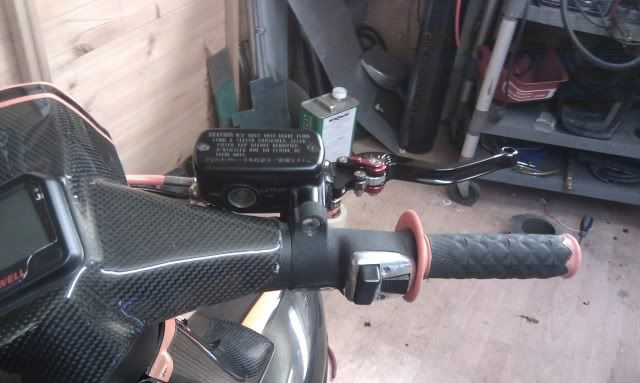

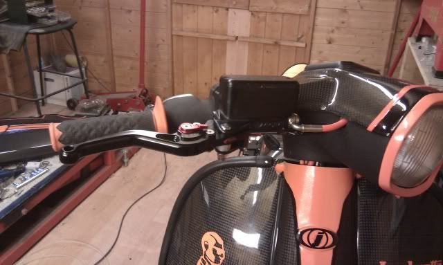

Well the CBR 600 master cylinder worked a real treat. It fitted with little fuss and I was able to use the PM Tuning lever too. Thanks to ForemanBob.
