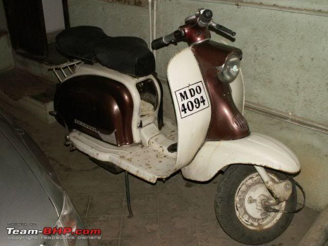

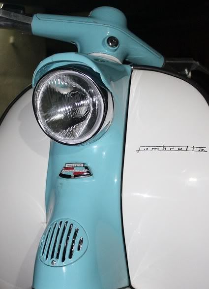

onefortheroad wrote: a lot of remade s2 legshields are Indian and taper in at the top like GP ones so beware!
yeah the Indian api series 2 leg shield are a different shape to Italian/Spanish as is the mudguard
both of the above are api s2
