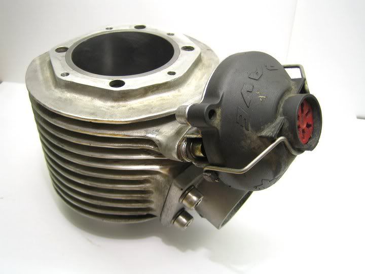

I haven't made my own powervalve cylinder as yet but I do have a rotax polini 153cc pv lc barrel on my smallframe and have been looking at a few barrels and thinking about converting one. I have a few rotax barrels too that use the blade type powervalve and think that this would be the easiet type to recreate on a TS/RB/Falc cylinder. You would need an ignitech powervavle control unit, an rd350 servo, an rs125 powerblade and a cylinder of your choice. It would require a skilled hand but it looks like it could be done quite easily. in simple terms : porting tools to cut a slot into the barrel, cnc a mounting plate, weld or bolt on plate, fit powerblade.
Advantages
Fixed height exhaust ports only produce power in a narrow powerband, If you raise the exhaust port on a road bike you can lose you bottom end power. This isnt a problem for someone who has raised the exhaust port and is sprinting or racing as there usually riding at max rpm and are always in the powerband. With a powerblade you can raise your exhaust port up high and then slot in the powerblade to fool the cylinder into thinking that you have a lower exhaust port height so that it still has power low down. You have your blade pushed in to create the low port height and use you low rpm power then once you start getting into the range where your raised port height starts to make power your slide your powerblade out, raise your exhaust port height/area and start to use the higher rpm power. basically you have the best of both worlds, low port height to get your low rpm power and then a raised port height to get your high rpm power.
Once you have your cylinder completed its time to set up your ignitech system. simply whack it on a dyno with the powerblade open so that your exhaust port is raised. open up the throttle and let her rip. Study that graph to find out where your power kicks in and note the rpm. Once you have your rpm set your power blade to open at the desired point. Simples :twisted:

does the valve have to be right at the exhaust port or could it be some how in the exhaust stub 10 or 20mm from the port :?:
it really has to be right on the piston to control port timings ,one lower down say 10/20mm wouldnt control the exhaust port opening duration but would just restrict flow
