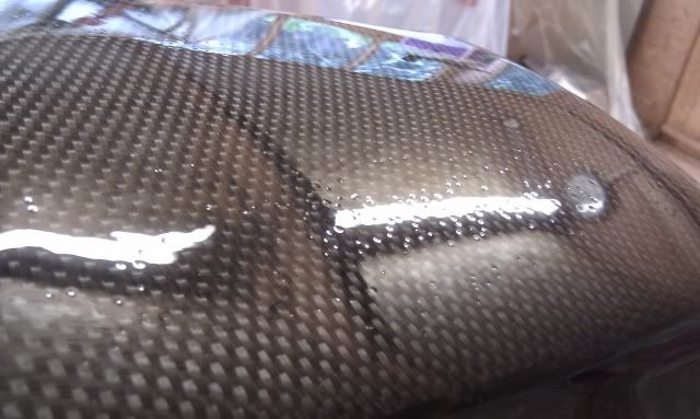

I had mixed fun doing mine. Like ric said panels using fibre glass polyester resin will be just fine to paint/clearcoat. But parts made using epoxy resin are a real pain to paint/clearcoat. Epoxy seams to sink into the tiny holes in the weave of the cloth and create pockets. Something in 2pack paint/clearcoat does'nt like this. But for some reason single pack clearcoat is fine.
This was the first clearcoat layer, but after a rub down and light layers it stayed burried.
