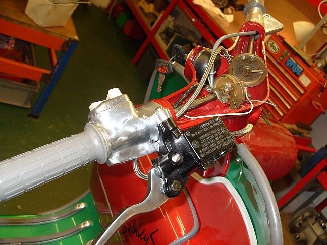

im rebuilding mine as we speak and saw what i did at the time,i ground some clearence near the throttle wheel on the headset clamp to give clearence for the braided hose,unfortunatly it cant be done in situ and needs to be planned before you put the headset on,as as previously said,i myself have seen it go through the bolt hole with the correct angled fitments,this save filing a groove in the headset botton thus keeping it origional
http://www.flickr.com/photos/anne-mark- ... 644733401/
http://www.flickr.com/photos/anne-mark- ... otostream/
this goes into headset and down fork tube stupidly(cant drop forks now :oops: ), jason frost did this originally and i just copied it :o :P cos its such a great idea

jason frost wrote:S1 but will work fine on S2
here some more pictures
http://www.absolutelyscooters.com/photg ... p?album=77
Jason thanks for that was looking at how to route on my Series 1 that looks spot on do you have any other internal pics or descriptions of what you did please ?
