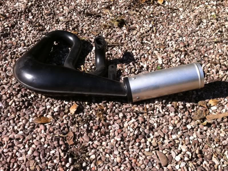

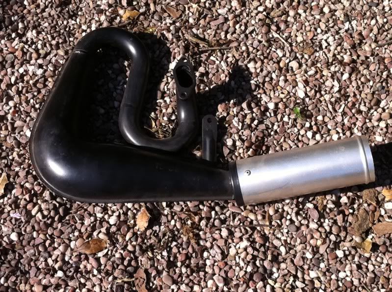

Here's my Amiga pipe

yes thats the one! mine is in 2 pieces though ,mind you the guy i got it from does a lot of tuning and modifiying of things,so perhaps he has had a fettle.and yes if there was a mounting bracket i could get hold of that would save me a lot of time trying to make one.

this is mine,as i said perhaps it has been modified ,was thinking the way to go would to weld some tabs either side and do a spring join.

Looks like he's added a bracket to attach to one of the cylinder studs and of course detached the 's' bend and created a slip joint.
The flange looks like it's been opened up to, I guess, match a Stage 4 exhaust port too.
I'll be interested to hear how you get on and find out how it performs - keep us posted.
