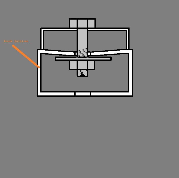

ive done some like that i used a thick plate on the outside with a 12mm hole in it then on the inside i made another thick plate that suited the inside of the fork leg also with a hole i heated the forks till cherry red then bolted both together and tightened the nut and bolt till it pulled the bent bit out . i did remove the washer on the outside of the forks as it was bent anyway

Did you leave the plates & nuts loosley in place prior to heating and then tighten up? Im presumming it would be way to hot to f**k about trying to do it after..... :o
Also sorry for being thick but did you have the nut on the outside when tightning down..?
As in, from the outside
threaded bolt
Large plate with 12m hole
nut
From the inside
thread through smaller plate with nut on
ta
ta
a drawing is in order
sydduckett wrote:Did you leave the plates & nuts loosley in place prior to heating and then tighten up? Im presumming it would be way to hot to f**k about trying to do it after..... :o
threaded bolt
nut
From the inside
ta
ta
no i heated forks in a vice and sloted everything on after, im a welder by trade so welding gloves were worn . the nut was on the inside as rics drawing

Ace drawing Ric!!! Star!

RICSPEED wrote:Image
This is action beyond the call, would be mentioned in dispatches for this back in the day.... ;) :D
ta
not bad for 15 mins
