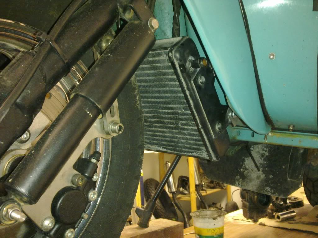

This is where i am planning to put the rad. what do you reckon? will it get enough air ?
I know ill need a stone guard and i m thinking of incorporation a sort of scoop with it.

not a lot of space for air circulation behind it , poss ok with a fan in front blowing thru. i use a intermotor sensor to turn my fan on but pump is running all the time and water flow is controlled by a gilera runner thermostat. you def need a wassel dc conversion to run this efficiently

mark wrote:not a lot of space for air circulation behind it , poss ok with a fan in front blowing thru. i use a intermotor sensor to turn my fan on but pump is running all the time and water flow is controlled by a gilera runner thermostat. you def need a wassel dc conversion to run this efficiently
Theres not enough space in front of the rad for a fan, and not alot of space behind for the warm air to escape ? :? so i may need to cut the leggies behind ? :?
