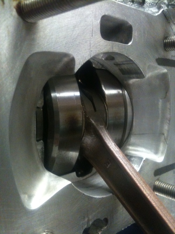

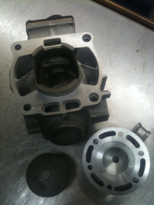

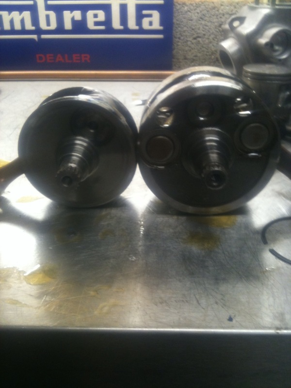

poor little lambretta engine was molested by a YZ

thats chris sturgess,s yz monster motor , i will get some photos and do a post on it as i will see him this weekend !!!

what he said...it's chris sturgess' motor ...or one of his latest.... mr happy b@11@x is thinking about selling it too build something even more outrageous! Obviously a projected 48hp and 35 lb of torque isn't enough power in walsall. :o

Won't the gearbox snap when the throttle is opened?

What clutch will it run?

I have two gearbox's that I had tested by a friend of mine
who tests gears and engine components to find out if they need hot or cold treatment, in this case they both
had cold treatment (frozen). The clutch was going to be the MB six plate ( packer plate ) with thin steels and
corks to make a 8 plate clutch.
The thing is i've decided to sell the engine to put the money into something different,
All the work was done by Mark at MB Developments a good few years ago and has done a great job on it. I'm
selling the engine case (Spanish) with the YZ 250 cylinder,piston, head, crank, 38mil Mikuni, and full Krober
race ignition. The top end is all original Yamaha YZ, and I have new gaskets
and o rings still in the packs.All the parts are new and unused.
