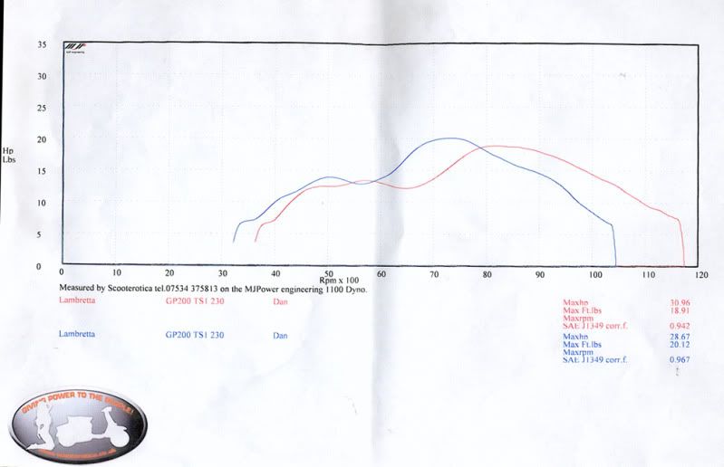

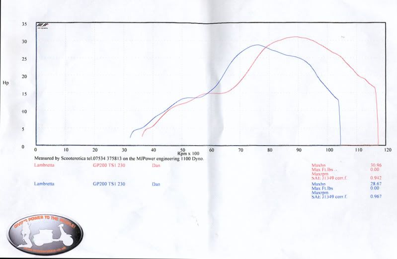

Anyways, the current power output of the engine we are using is 28.7bhp and I have an ADS fast road pipe which I have compared back 2 back with a JL4 and the results are very similar on both pipes, the ADS pipe does have a smoother top end BHP curve though, and the volume of the pipe really draws the gasses through, to the extend that it would need up-jetting in comparison to the JL4. JL's were my favourite production/off the shelf pipes up until now, but the price, quality and performance of the ADS pipes has won me over. So I was deciding whether to go the hooligan route on the road with this pipe, or fit the touring version and go for gearing based performance......and I’ve decided that’s what I’ll do. I have the ADS tourer winging its way to me as we speak, and as soon as that is dynoed I’ll post the graphs, I’m hoping for approx 24-26bhp and 22-24ft-lbs at around 6k RPM (ish)........but we shall see what happens, it might be better, it might be worse, but whatever it is I’ll gear it up accordingly, ride the f@@ker and post the results.

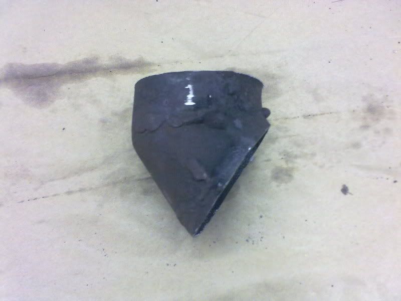

On top of all this, whilst building this engine, dynoing different pipes, thinking about gearing and so on, Sean and I had some conversations about this, that & the other, and Sean really wanted to experiment with the tuned length of a pipe on this motor. So what he did was asses the engines port timings, measure the tuned length of a JL4 pipe, and then reduce it by approx 2 inches. Ultimately this had the effect of pushing the power approx 1000-1200rpm further up the range, but more importantly it increased peak BHP by 2.3 to 31bhp, and gave a huge increase in area under the graph. This result is exactly what Sean predicted it would do..
Now of course this pipe is no good for what i’m doing as a road-going scooter.......its going in the opposite direction of what im trying to achieve...lol.....but still i thought it was an interesting topic for discussion and a fun experiment. I think the ADS Race pipe results will be almost identical to this shortened pipe, and as those pipes are of superior quality to a JL4 (with better clearance and less cracking etc) I’ll be running on of those from Chis when I sprint and race the scoot, and keep the touring setup for the road.

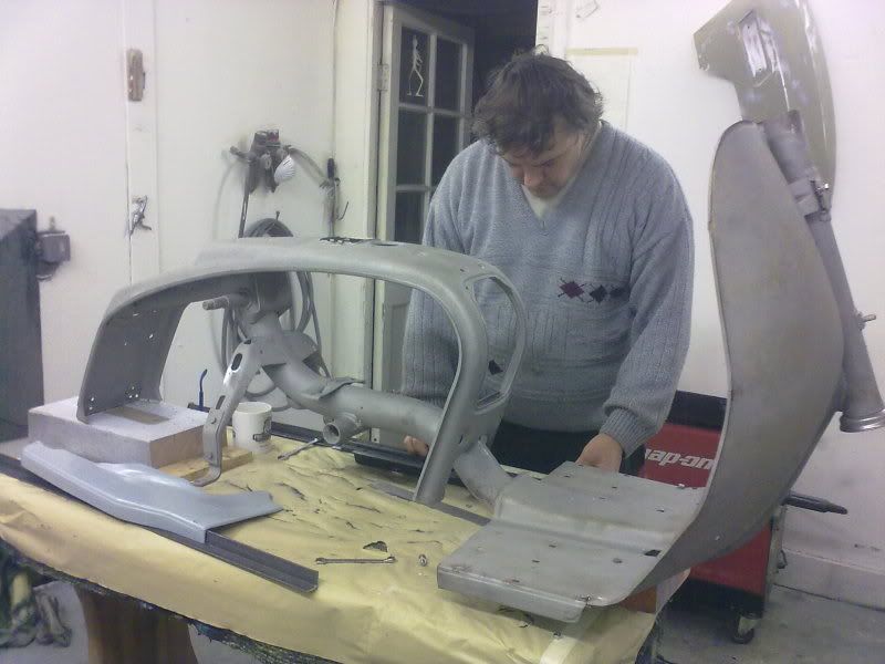

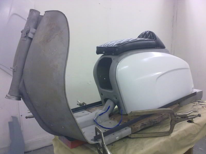

So thats what we're on with at the moment building a road scooter/engine for low revs and 4.2 gearing.....and having an option to sprint/race if i want to. Here's a pic of the scoot when it was at dry build stage, the bit we chopped out of the JL4 and the JL4 before (original) and after (shortened) dyno graph.
Below: BHP
Below: Ft-Lbs torque

Sorry for another non motor question, but why are the runners/legshield being held down by angle iron and clamps? Quicker than nut and bolting it?
Good luck on the experiment.
That's not going anywhere...
dirtyhandslopez wrote:Sorry for another non motor question, but why are the runners/legshield being held down by angle iron and clamps? Quicker than nut and bolting it?
I was fitting a new main strut /crossmember....

Cut and shut JL4 that revs to 12k V's ADS tourer that revs to 7k!! :shock: No pressure then LOL. :D :D :D
I think it'll be an interesting graph to see, I have one against a JL4 on th JB TS240 'big weld' motor but don't want to hijack ya thread, I was pleased with the results. :D
Peak about 7 I would think on that motor in the real world, similar power to std JL4 maybe up on torque a touch.........Whens it going on?!!? :)

as Dan said,the Ads fast road pipe was a very good alternative to the JL4...and in fact far better in terms of quality of build and ground clearance and also price wise...all very good reasons ....
our experiments with the JL4 were in no way meant to be a comparrison ...just done for our benefit only and just for fun really but it just shows somewhat what may be expected of a race pipe... designed specially and made to the same quality of other Ads/chis pipes :D

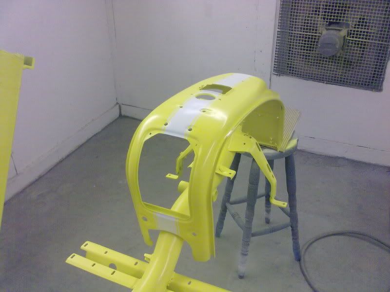

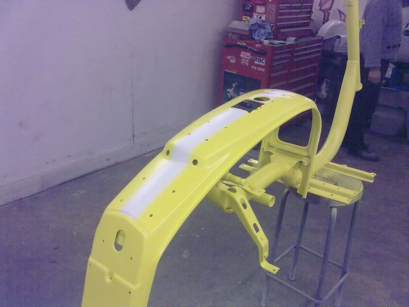

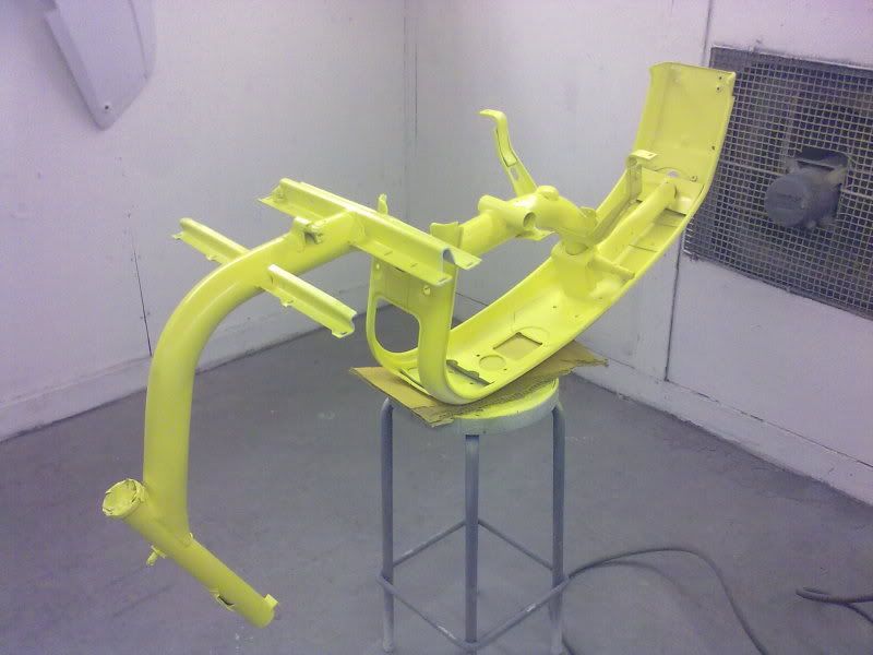

Scooter paint job started.........bright aint it!! LOL

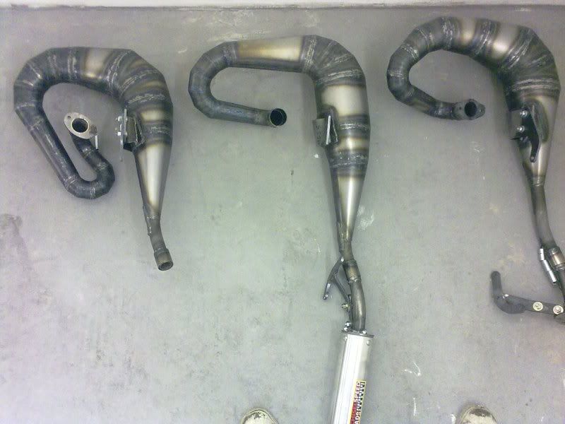

A few exhausts lined up for testing on the TS1........ADS Touring, Fast Road and Race from left to right.
