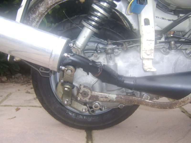

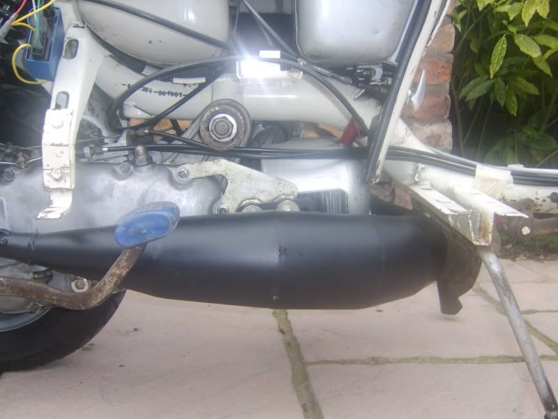

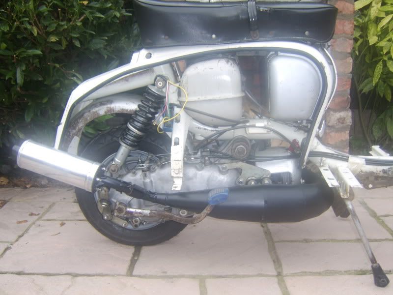

Can't seem to get my taffspeed exhaust to fit right? Footboard outrigger is going to hit the exhaust before the suspension bottoms out.Doesn't want to sit any closer to the engine casing. Tried a longer shock. Any ideas for a thicko? Does it look to be sitting right? Thanks.

try loosening all the fittings and put the end can on the outside of that bracket it the back it should twist the can round and angle the expansion pipe down a bit.... you will have to trim a bit out of the back of the running boards to clear the pipe.... i've had 2 taffys on my bike now with no fitting problems i'm running a shortened rear shock as well as concentric cones...
