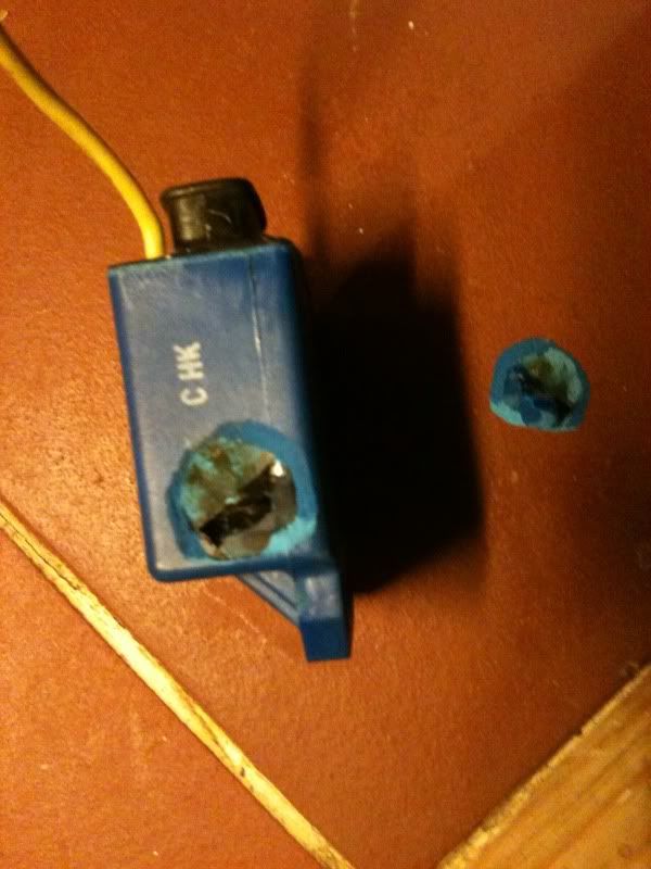

I tested the stator with my meter on ohms and all the readings were there or there abouts so took the known good cdi off my LiS and bingo, we have sparks :bouncing:
Looked at the Ducatti one that I'd just taken off and noticed a section of the casing sticking up. prizit open with a screwdriver and saw this
Smells of burn electronics too.
Definately wondering about vibration now, as far as I know, there aren't many components inside a CDI, HT coil, Capacitor and a SCR (silicon controlled rectifier). I reckon the only thing that would blow out a lump of plastic like that would be the capacitor and they are suseptible to vibration. Some form of flexible mount needed I think.
i can feel a rubber mounted bracket comming on :roll:
