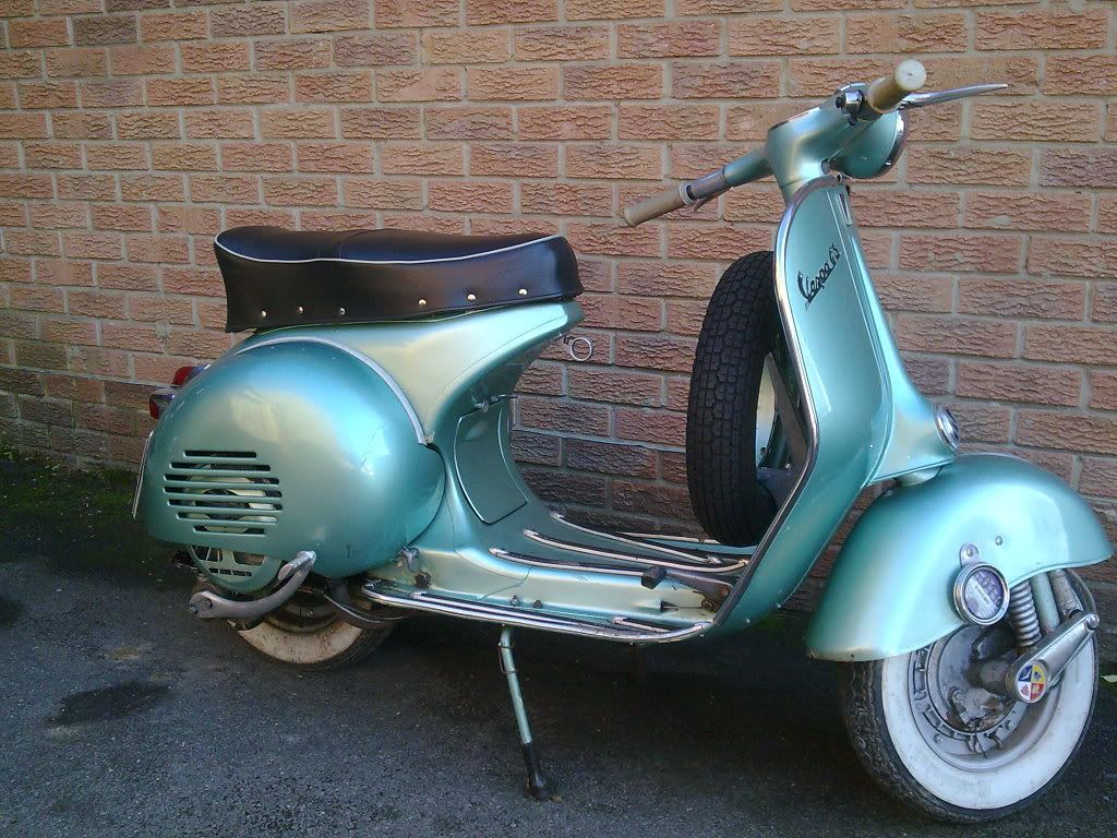

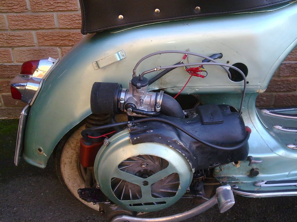

Had this a few years as always liked the shape.It ran shite when i got it but whipped the motor out and had it a bit modernised so im not one of these old duffers holding the traffic up at 45mph.Jerome at Readspeed done a center plug head and some very slight porting.Ripped some guts out of the exhust and rejetted the standard carb.Ive now fitted a 25 Dellorto instead.It actualy goes ok for an old 50`s 150 and such a smooth motor,originaly was gonna stick a P2 lump in it but when i heard it,just couldnt do it.

are the forks / mudguard standard GS 150 Spec?

Well done, that's cool - I've always wanted to do a mild tune on my VS5. I remember someone did a Mikuni conversion a few years ago.
And is that just rubber hose coming off the stock, stubby manifold!?!

dansuper wrote:Well done, that's cool - I've always wanted to do a mild tune on my VS5. I remember someone did a Mikuni conversion a few years ago.
PS - sorry to be picky, but Gran Sport, not Grand Sport. ;-)
Mine is a one off and they called it a grand sport VS6 ;) . Its a piece of radiator hose,thats it.Runs better but lost torque and power due to longer manifold.I want to make another manifold to hold a P200 carb and airbox which would be better.That to can be a hose on the stub then fixed to the casing like the standard airbox.If you knock one up in the meantime,bare me in mind ;)

soullad wrote:are the forks / mudguard standard GS 150 Spec?
Guess so unless anyone knows different.
