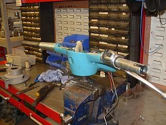

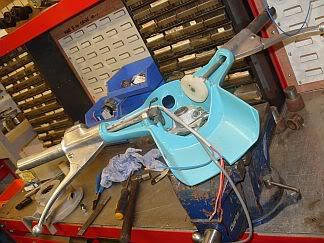

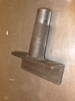

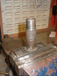

Easy to make from the top of some fecked forks and some angle iron, makes the job so easy.
put it in the vice
fit the fork clamp to the handlebars then fit them on the tool
it can now be moved around to work on
