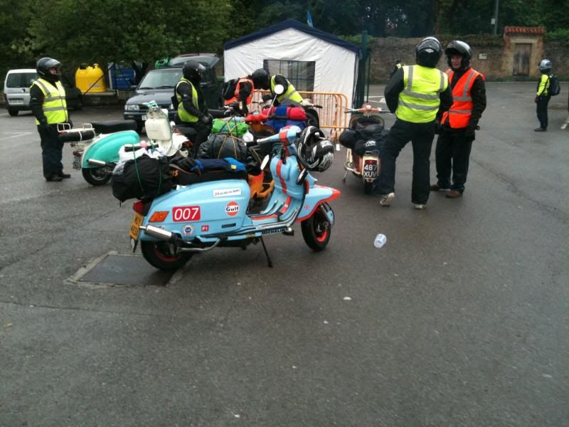

I also decided that I would use it as my ride to Gijon for the 2010 Euro Lambretta event so I had a completion target to aim for. Work actually started in February 2010.

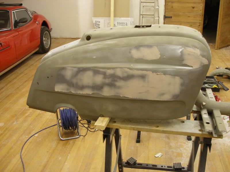

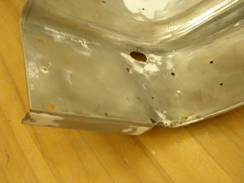

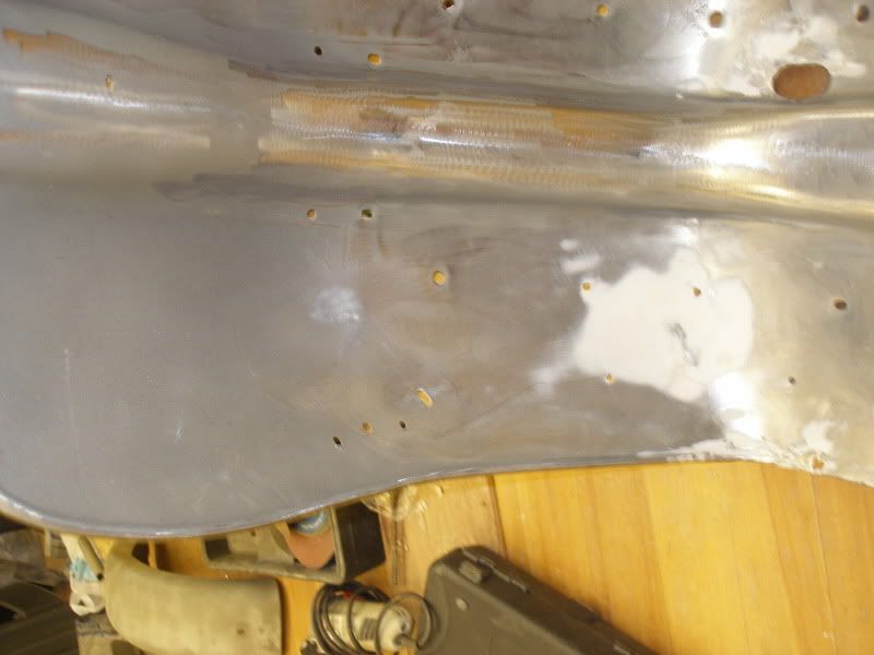

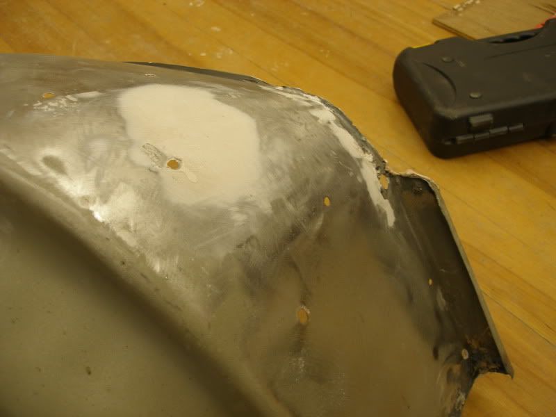

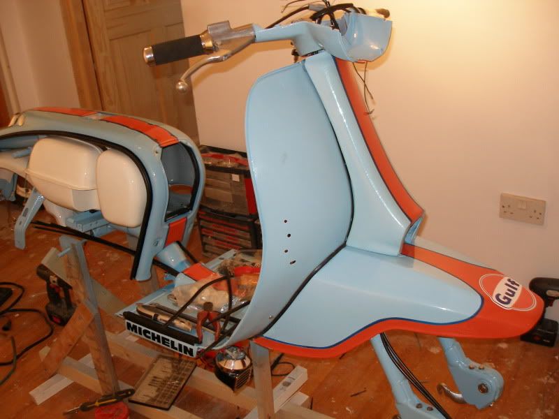

Blasting revealed some rust damage and a few dents which needed attention
Primer going on

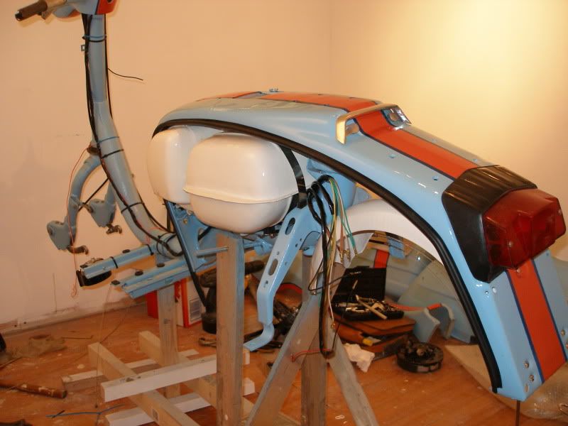

Base coat
Masking for the pinstripes due to the striping tape not arriving on time

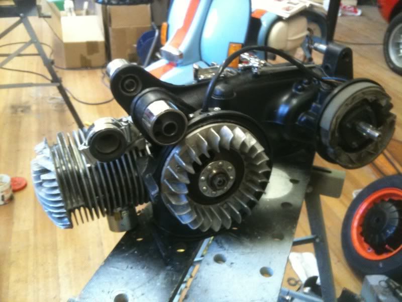

Mick Abbey tuned Ally 225 barrel
Case opend to match

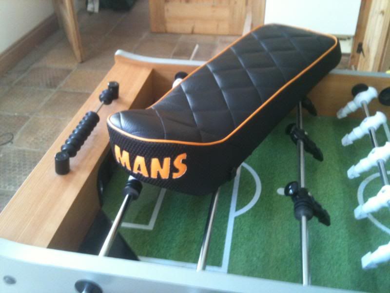

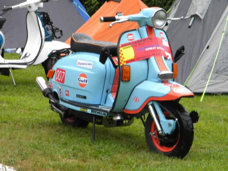

The scoot came with a strange looking Ancilotti type seat which had a home made cover on it so I cut the back and got it recovered by a local trimmer in Norwich.

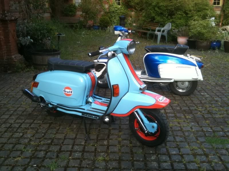

Finished except for a few crucial stickers which didn’t arrive until the night befor my departure for Gijon

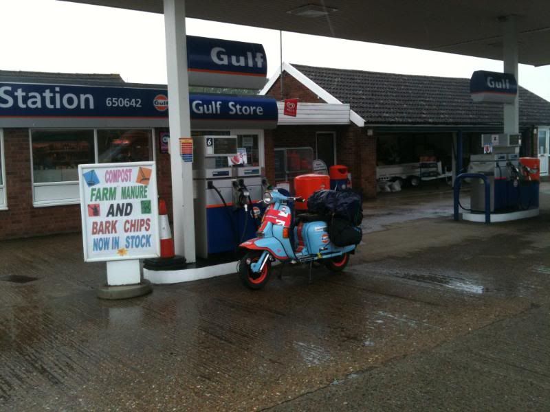

Filling up at the local Gulf Garage
The engine spec is : Indian 225 barrel ported by Mick Abbey, 30mm PHBH, JL3, Indian electronic with August 6000.

Really like that Colin. Great job. What does the motor run like?
Diablo wrote:Really like that Colin. Great job. What does the motor run like?
Cheers Al, they motor runs very well except for a large boggy spot in the mid range which I'm advised may well have something to do with a low compression ratio (about 7.2 uncorrected). I may also have to drop the gearing but I thought I'd get the head seen to first and see how it handles it.
