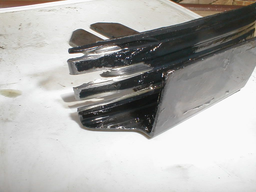

SX150 chain sounded a bit rattley lately so I whipped of the chain case to take a look.....
Needless to say there's a nice nylon one in there now!
There were some significant bits of steel stuck to the drain plug magnet :shock:
Feck me.. :o ..was the chain seriously slack in there sideout..MB chain guard I hope..

Lam46 wrote:Feck me.. :o ..was the chain seriously slack in there sideout..MB chain guard I hope..
As slack as a very slack thing! :o
Just to clarify that is NOT an MB chain guide in the picture, it's a standard one.
I would fit an uprated chain guide in any engine, even a bog standard one, it's one worry that can easily be eliminated.
Yes Ian, I think Lam46 was referring to the replacement, rather than the original which was standard 1967 Innocenti ;)

sideout wrote:I think Lam46 was referring to the replacement
Yes Ian I was referring to making sure you fit an MB (genuine) chain guard like I have fitted in mine and not one of many copys of Marks idea..
