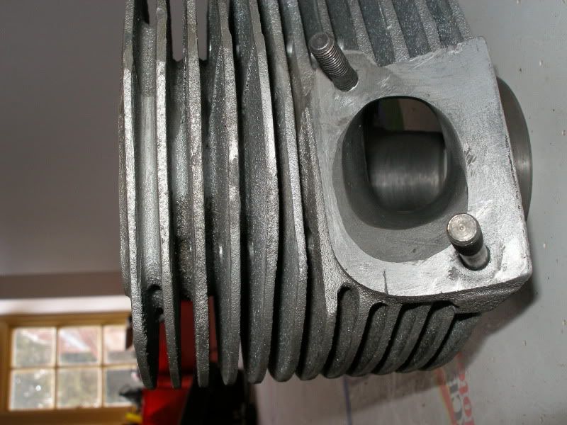

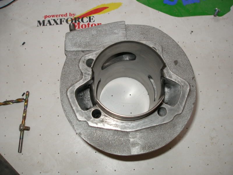

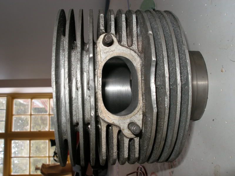

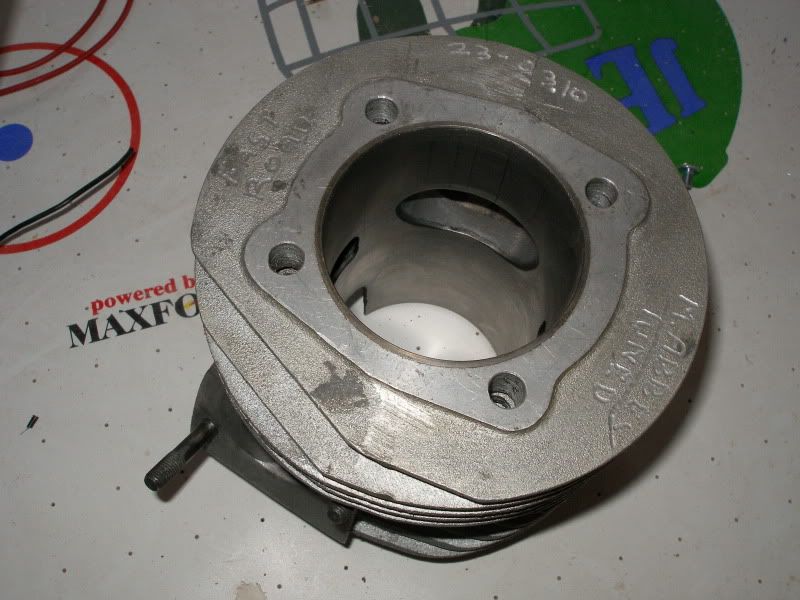

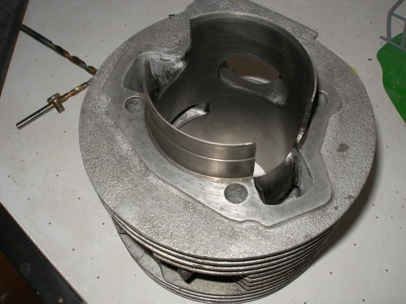

I bought a cheap Indian ally 225 kit off ebay and gave it to Mick to play with. I wanted something with reasonable torque but still able to do rev a bit.
Really nice work, I gave hime the inlet amnd the exhaust stub which he also re-worked and flowed. The inlet port and manifold have been packed and completely reworked wto give a straighter flow into the cylinder.

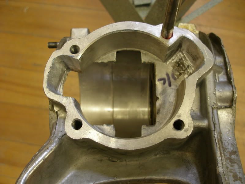

Case opened up by me to match transfers
Despite having some fairly extreme port timings the result is a very pleasant ride using moderate revs and a LOT of fun if you use the gear box.

So what port timings are you talking about ?
Stokie wrote:So what port timings are you talking about ?
120 transfers, 175 inlet and 182 exhaust.
I've a way to go sorting the top end jetting but it's got a very pronounced powerband as those timings might suggest but it is very docile and rideable at lower speeds with useful torque in the mid range.
