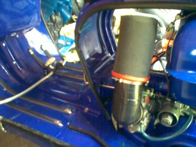

Anyone else had any problems running with one of these? I'm running a Mick Abbey tuned Indian Ally 225 kit and was finding that it was bogging down at around 1/2 to 3/4 throttle. I first lowered the needle but that only made a slight diffence. I then came down on the main from 128 to 125 but there was no change :? I then took the filter off and found that just over 3/4 throttle, all hell broke loose and it took of like a rocket :o

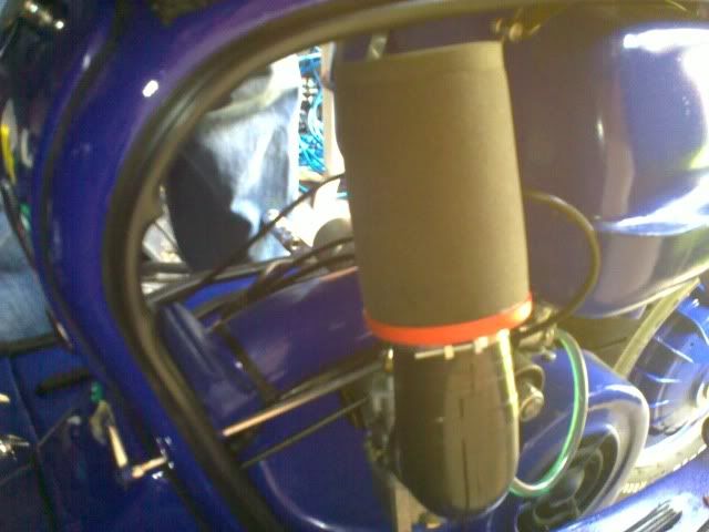

Experimenting with the filter reveled that the elbow on the breathing sweet is very flimsy and the panel squashes it by at least 1/2" (28PHBH) so I was wondering if this is restricting the airlow too much?
As a foot note, I was so facinated when it cleared that I held the throttle open to see what it would do, I bottled out at about 65ish and as soon as I shut the throttle, it nipped up :oops: :roll: By the time I had braked to a stop it had freed off and kicked over and ran fine. Be all right or should I have the barrel off and clean it up? maybe do a bit more jetting first in case it nips again?

Are you running this breathsweet:

In my experience it's a lot easier to jet an open mouthed "big" carb, or a carb with a filter straight on the side, than one with an elbow.
Whether it's issues with the pulses hitting the elbow and bouncing back, or whether it's spitback, I don't honestly know. I'm pretty certain with loads of patience you can jet the carb through it, but it does make life hard (I've never tried on the breathing sweet one though). Perhaps a dyno session might be an idea?
Personal opinion, if you've nipped up, I'd take it off and have a look. Otherwise you'll always be thinking..........

Lam46 wrote:Are you running this breathsweet:
Yes that's the one, I have a 13 litre tank so I've raked it back at about 45 degrees so the sock is just above the fan cowl. Without the panel on, my elbow extends as far as the first rear runner strip :shock:
Paul, yes, I think you're right, I'll set it up without the filter. I will take the top end off before Spain but as there's more than a chance that it could nip up again during the jetting process, I'll leave it for now ;)

My manifold is not inclined, it's possible that if it was a downdraft type it could be shortened a bit and maybe aleviate the squashing. In my case though Mick Abbey has packed and re-shaped the inlet mainifold and port to get better flow and if I change the manifold I'll have to sent the whole lot up to him for modding....maybe after the Euro 8-)
