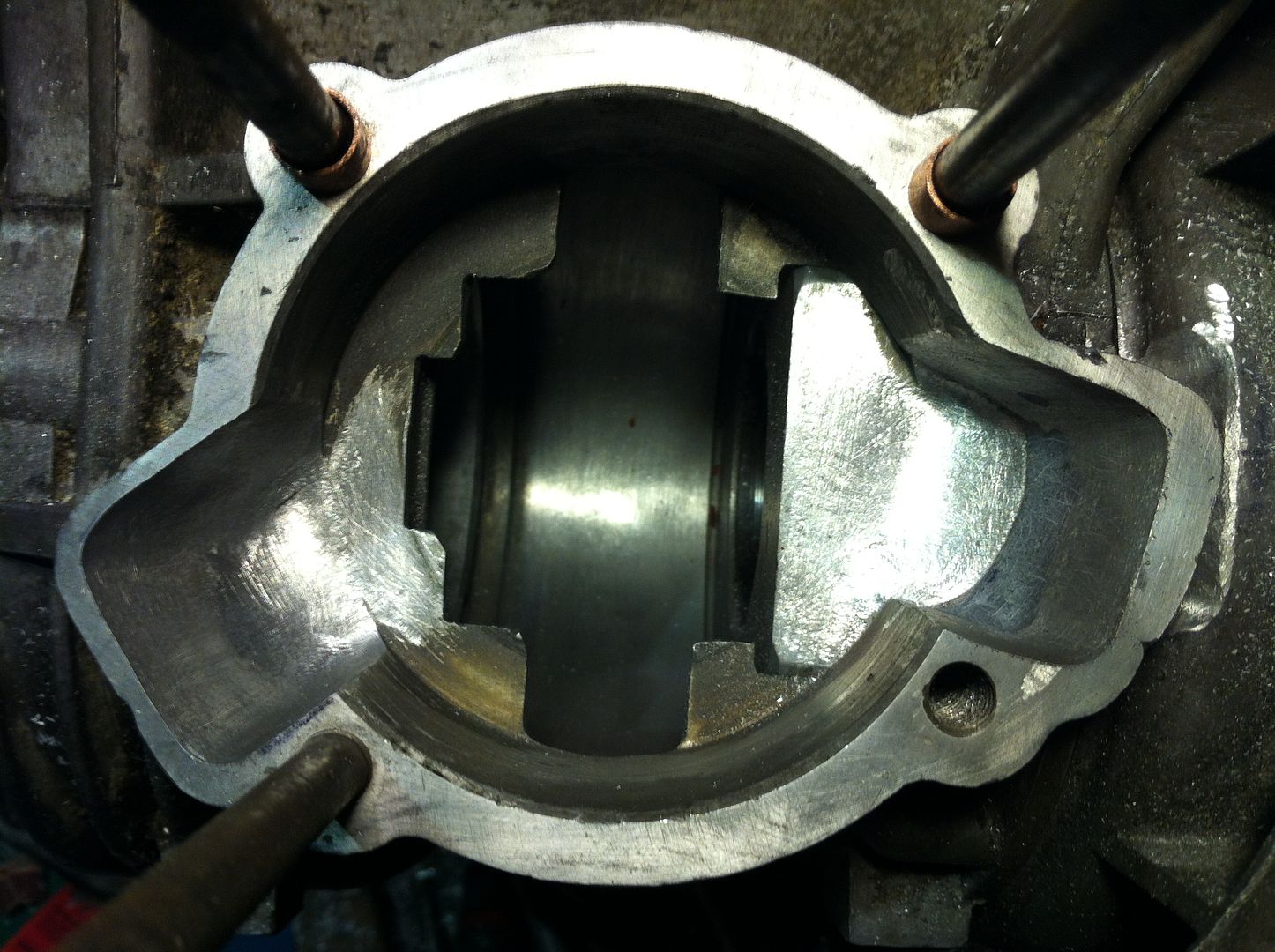

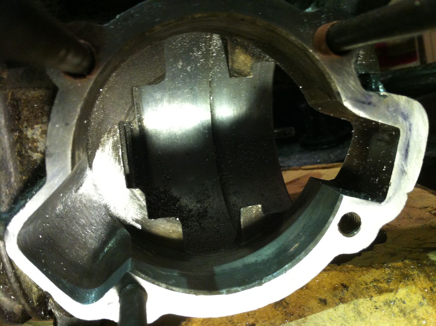

begining of the porting job:

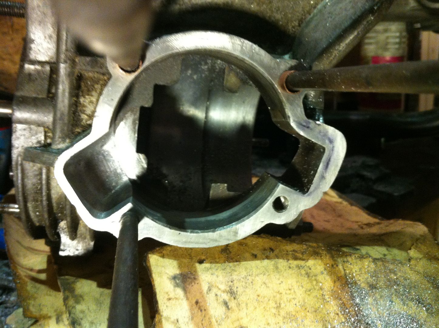

fastfrog
Posts: 412
Location: Paris, Taxes
right one almost finished: size difference is impressive

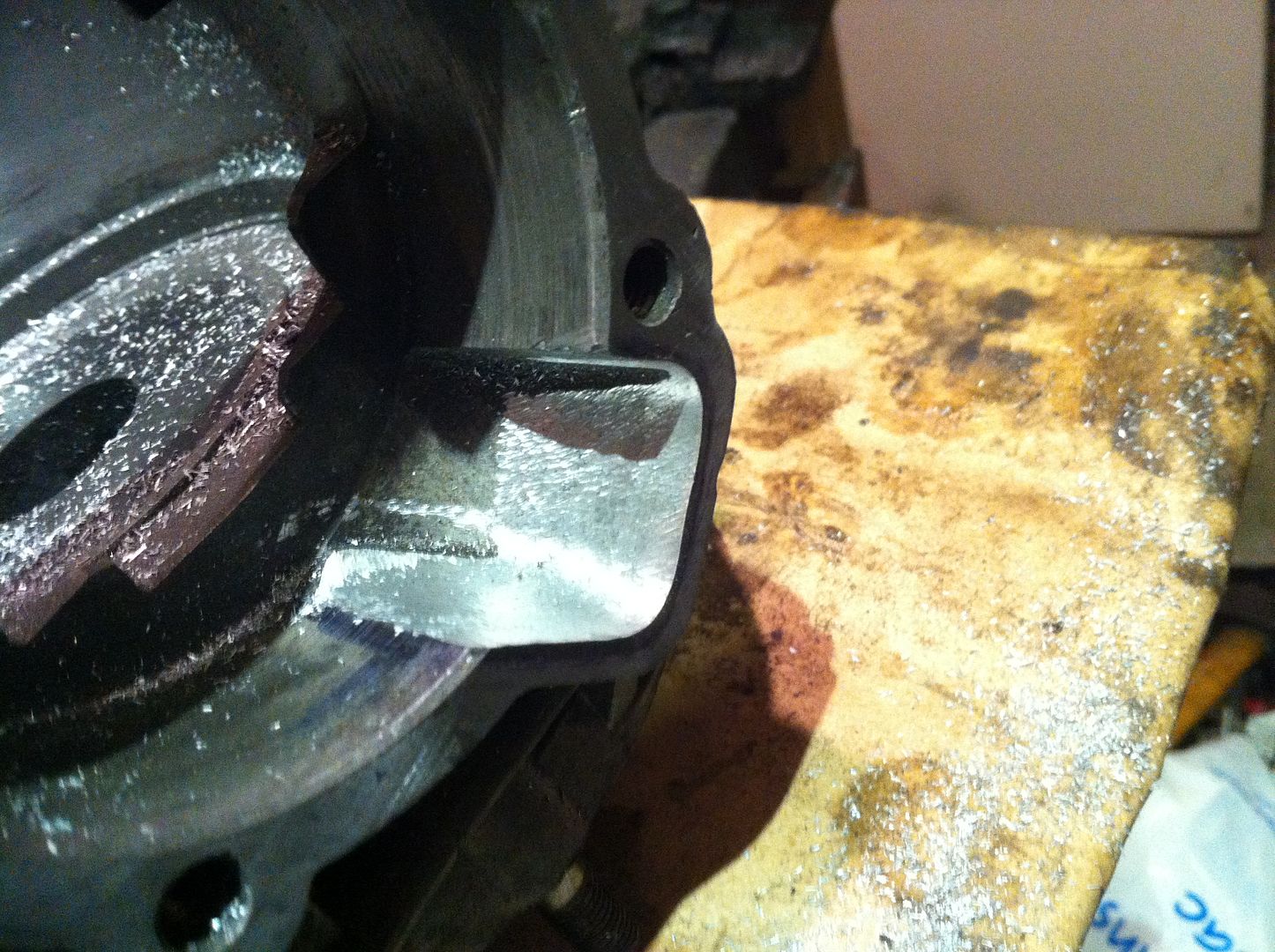

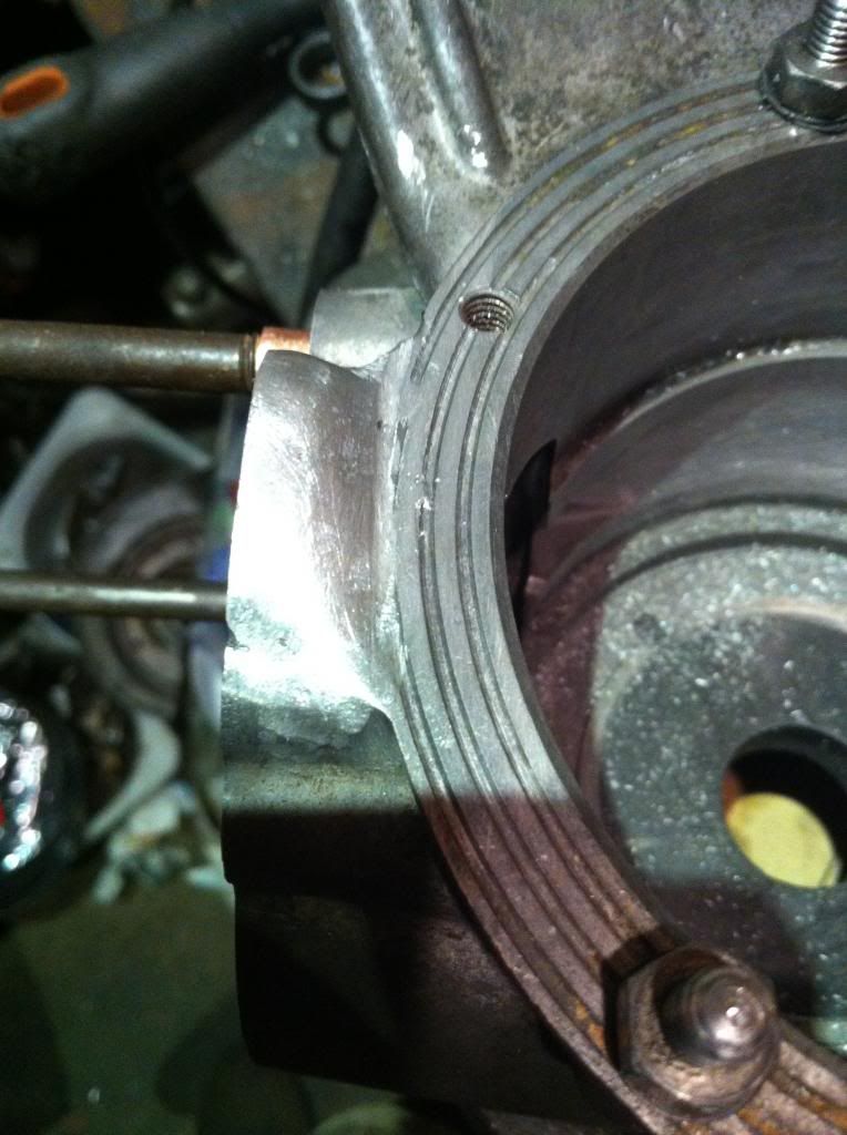

fastfrog
Posts: 412
opposite transfer is a mess. As if mag flange wasn't matching the initial transfer design.... I had to fill a 3mm space with epoxy...

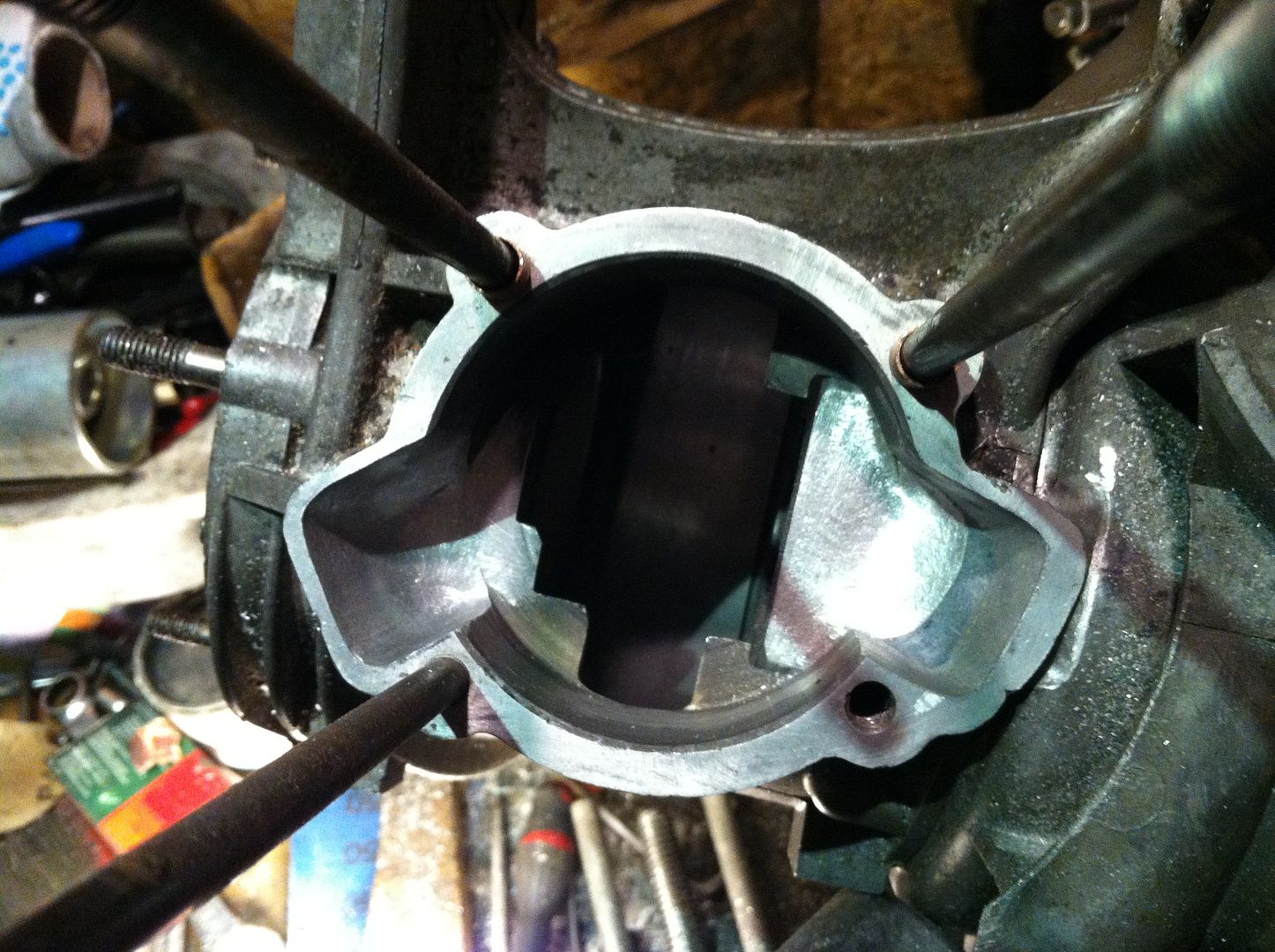

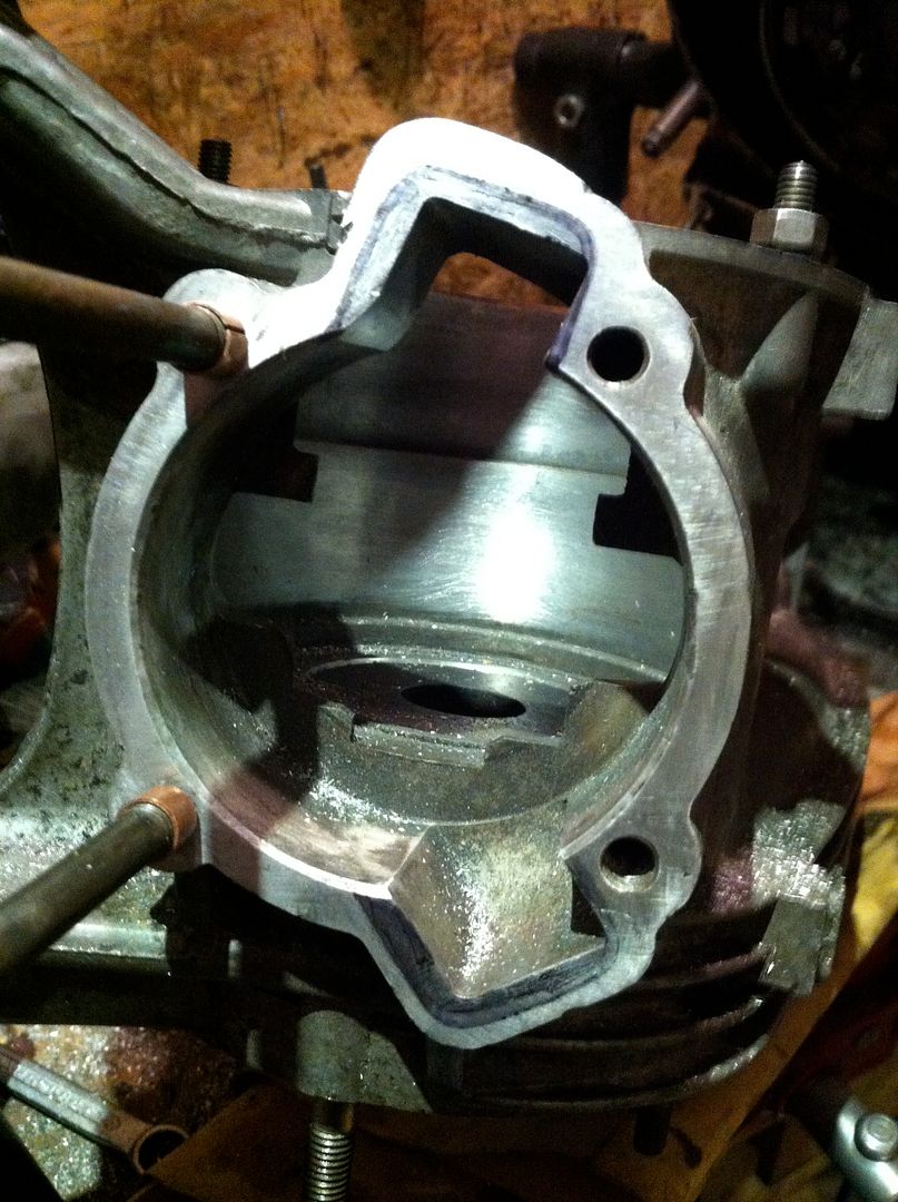

fastfrog
Posts: 412
case porting close to the finish line:

That's some might fine work there 8-)

slangen
Posts: 171
Main scooter: TV200
Very nice work mate, thanks for sharing. I wish my ports where that tidy and BIG! What epoxy are you using Sir?
