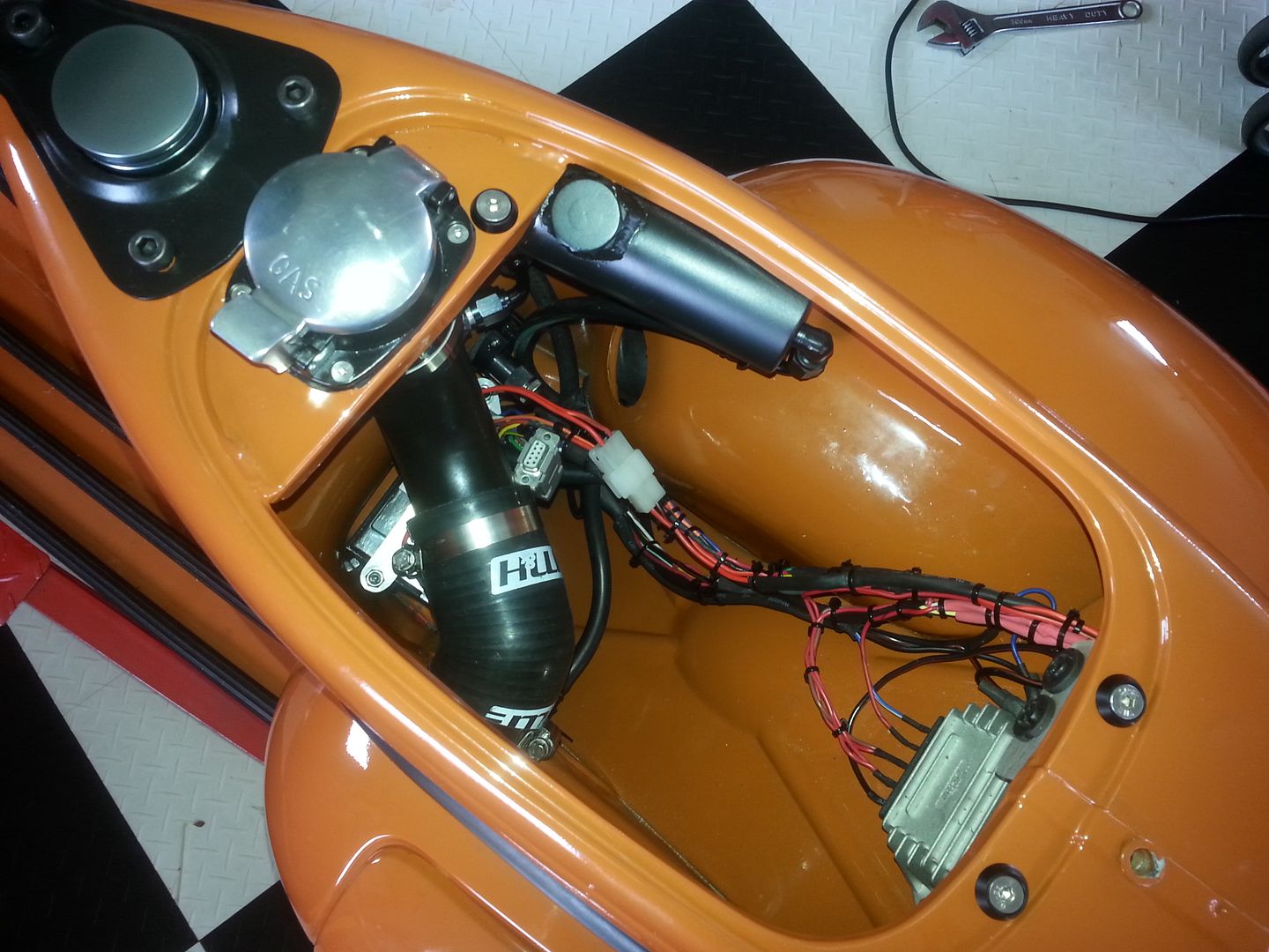

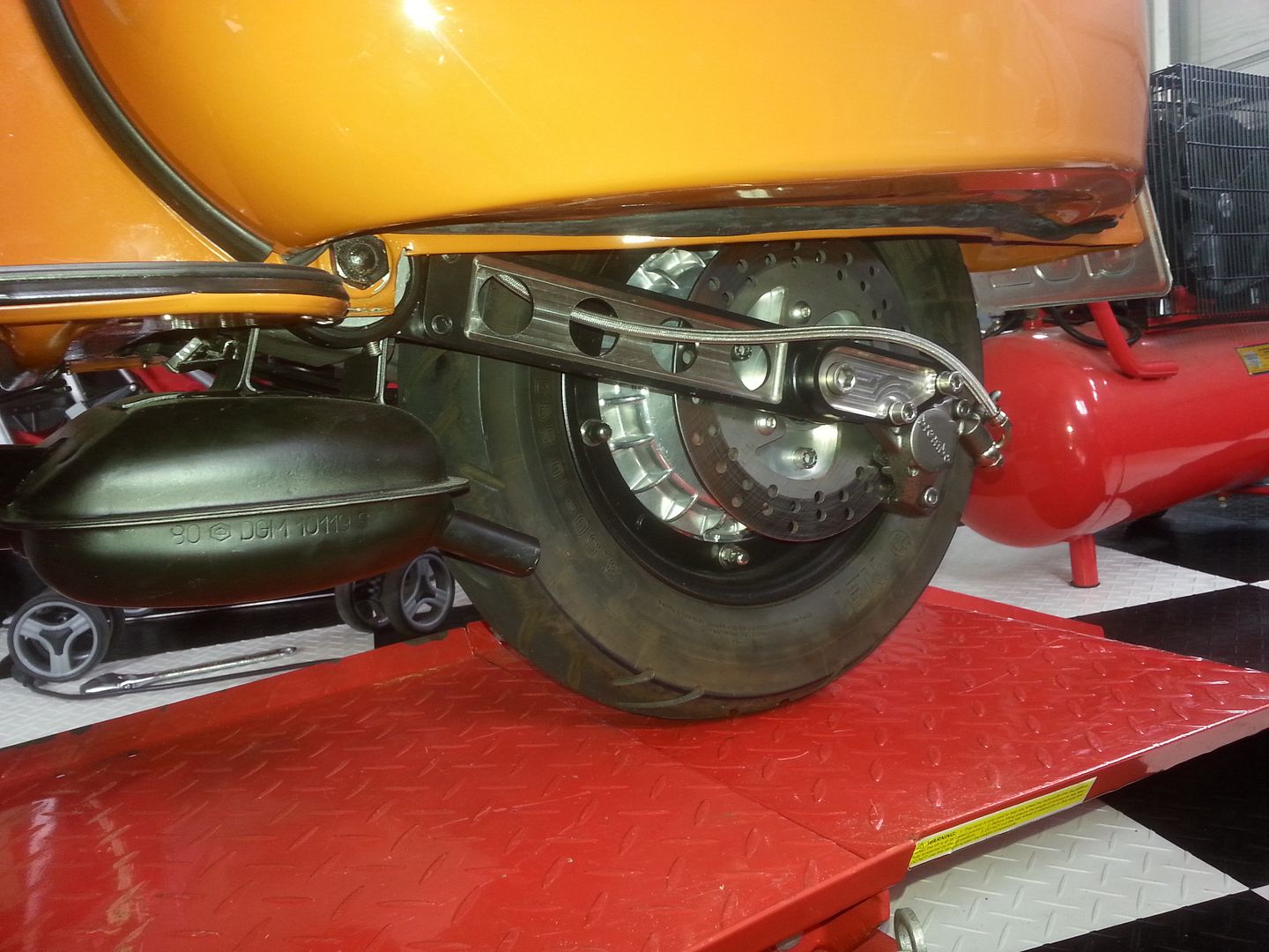

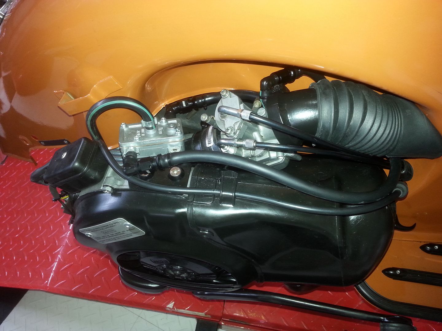

well have been doing a few small things on the scoot while i wait for the new exhaust for it, tidyed up the wiring and am working on getting the rear disk to work a lil better.

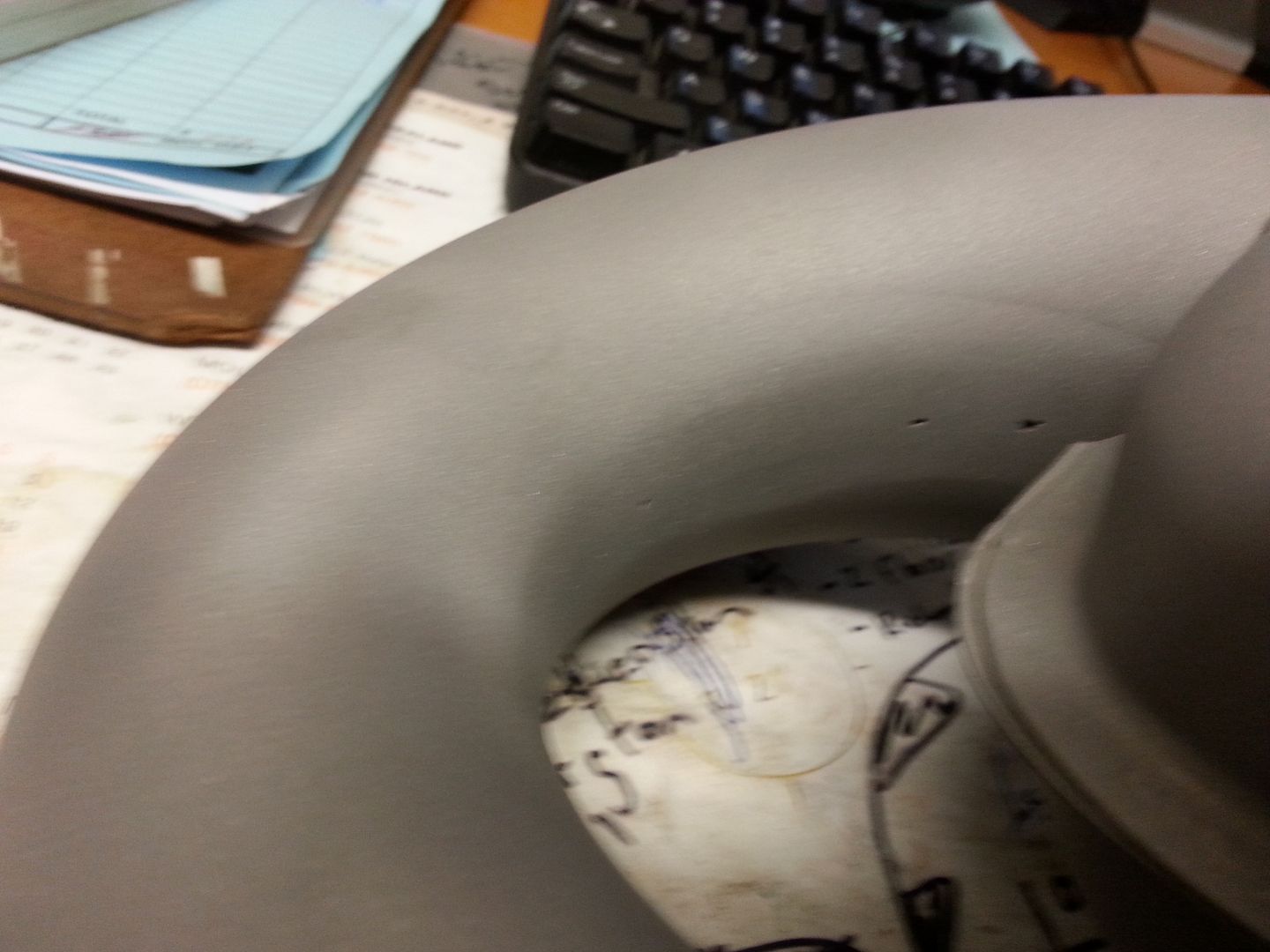

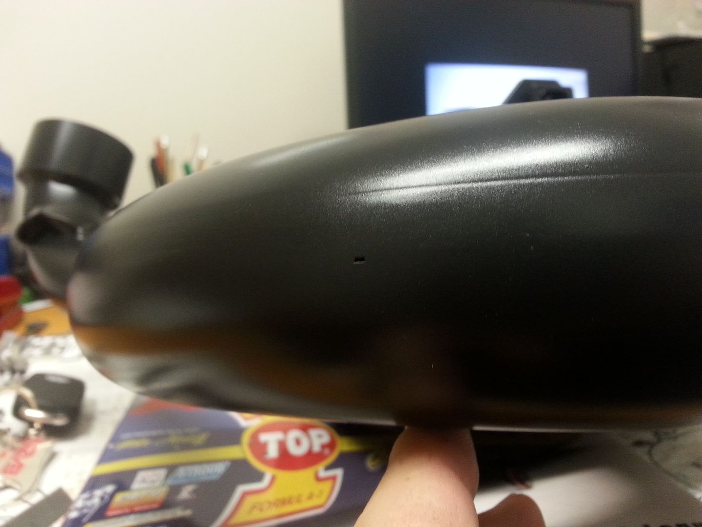

Well new BGM big box turned up, nice exhaust, well made, but a couple of problems, stripped the factory paint of it to coat in in a special exhaust coating i do at work only to find about 4 holes i it.
any why had them repaired and got the pipe coated up and fitted, only to find that the stand now hits this pipe.

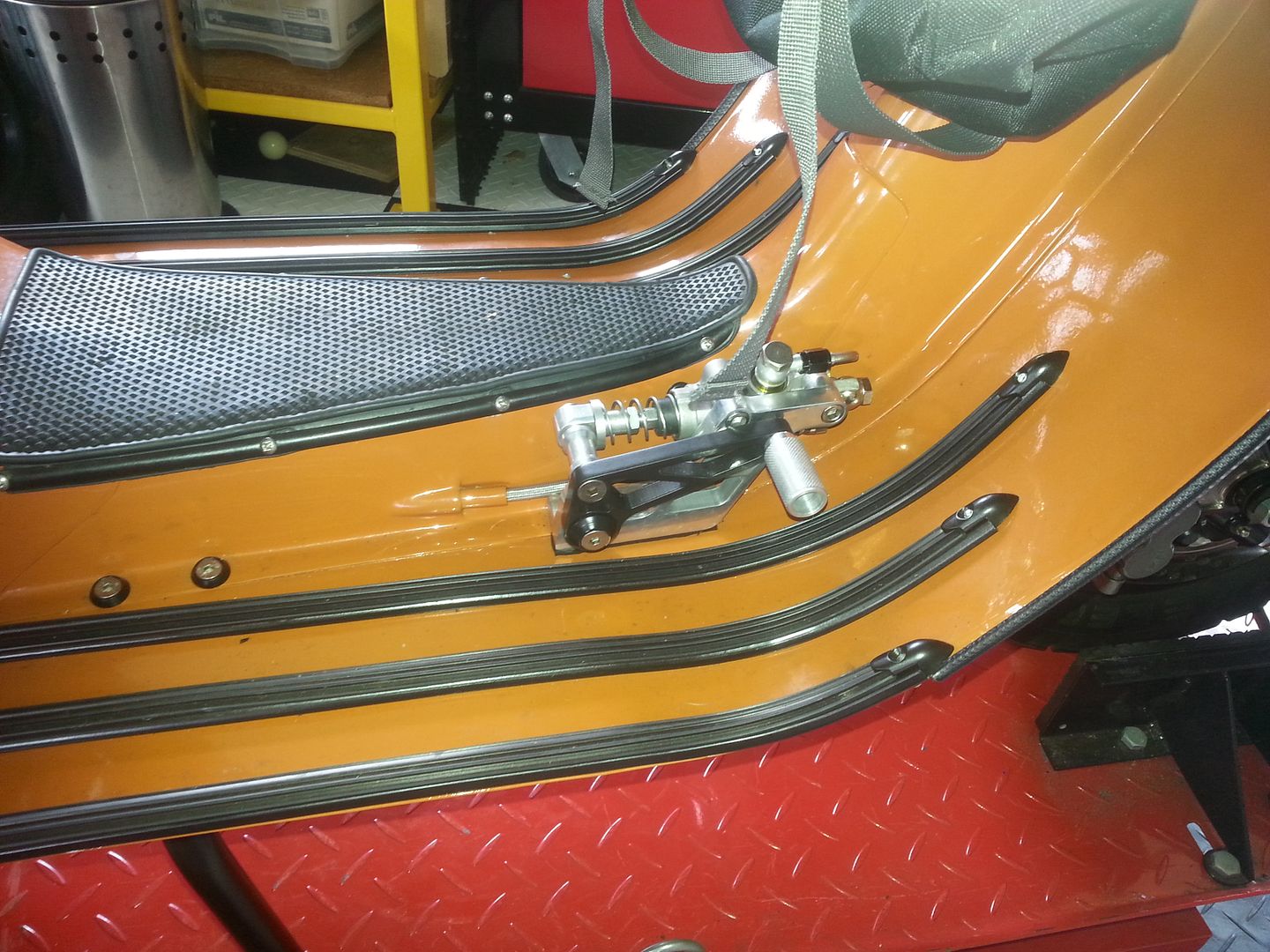

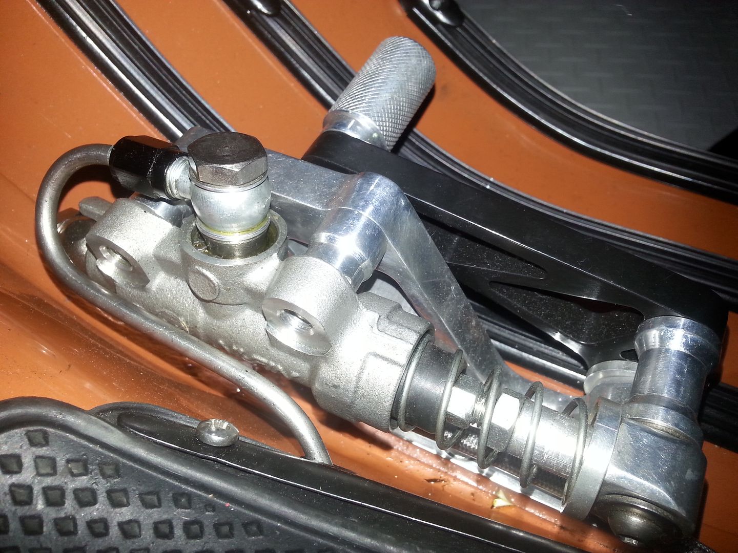

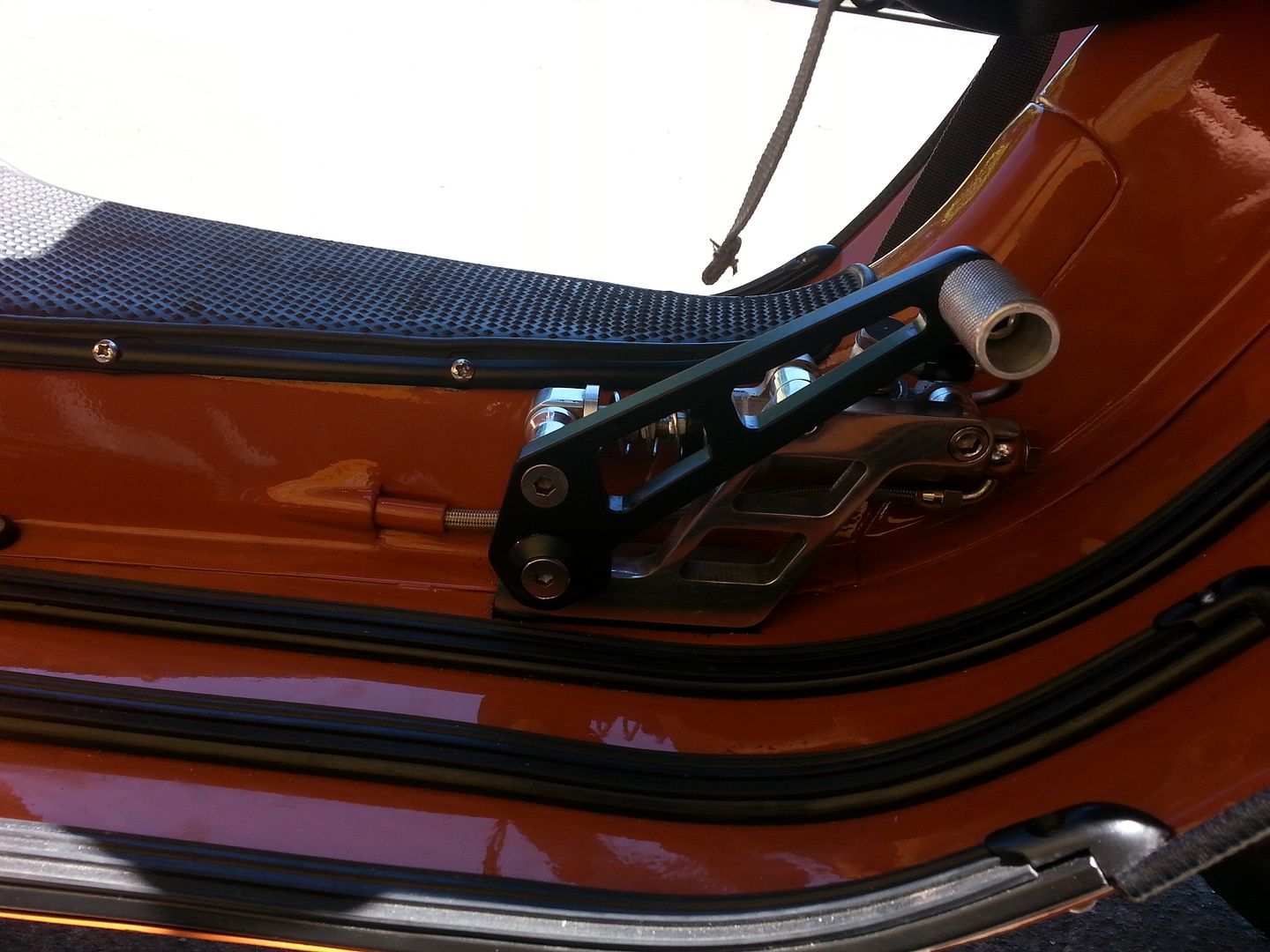

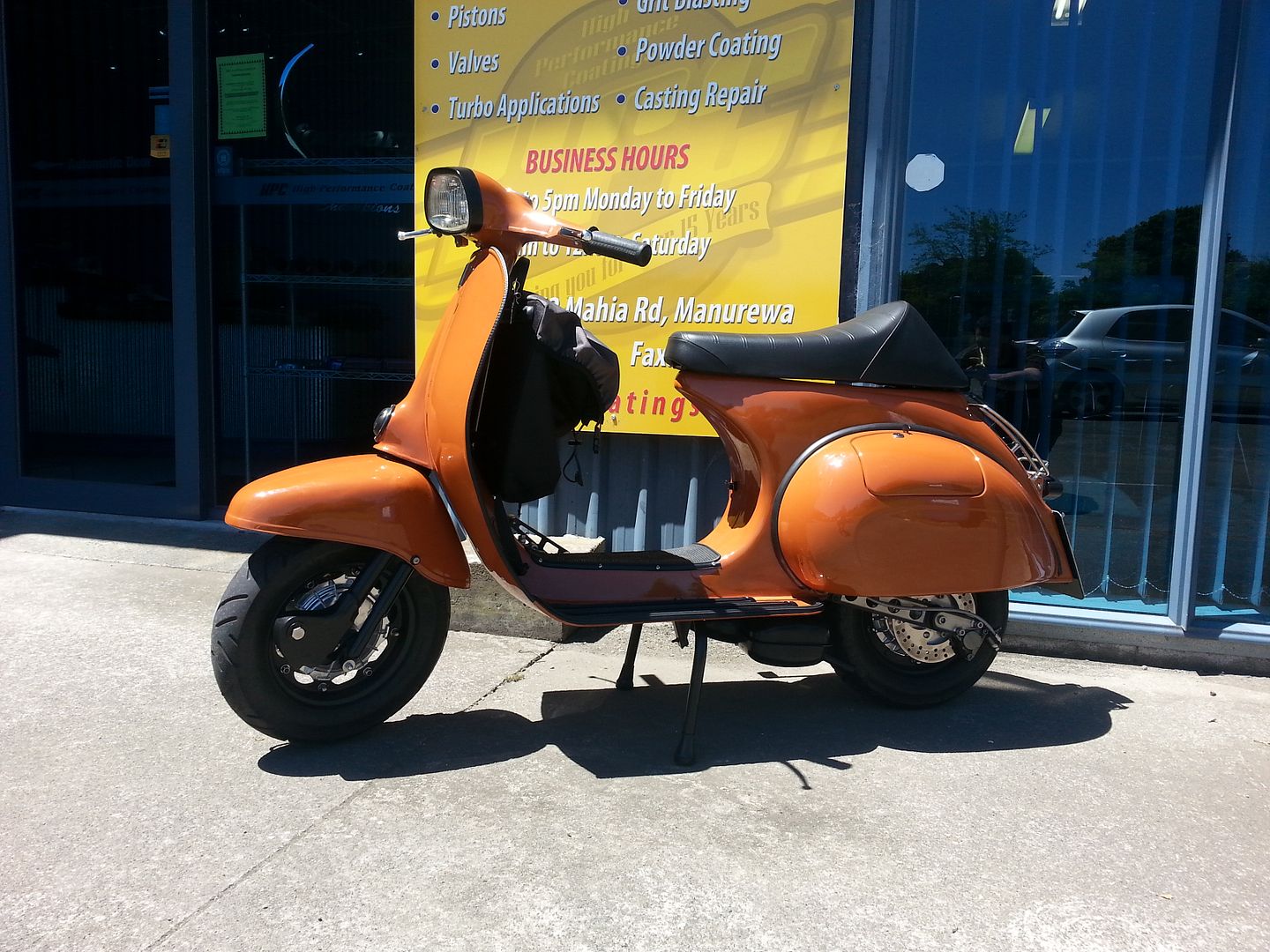

Was very happy with the Dyno, got 19hp and 17flb. only thing left to do is make a new rear brake pedal as im not very happy with the one that came on the kit, needs to higher so you can get to it easier.
gpts1
Posts: 155
Started using the scoot for commuter duty, has been really nice to ride, made a new rear brake pedal, a lil longer and more height in it and it works much better and is easier to get to.

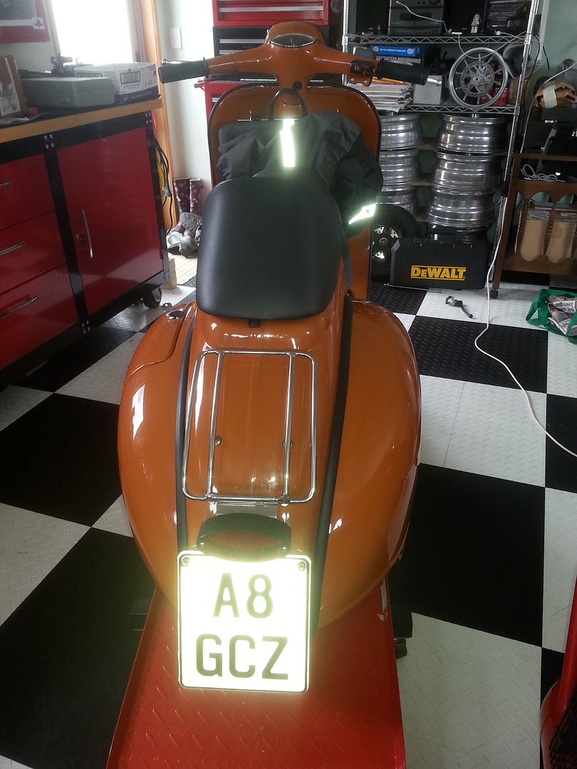

Stunning. Great work. 8-) 8-)
tonydevon
Posts: 553
Main scooter: '71 GP125
Location: Northam, Devonshire
flawless, I love the attention to detail and way that theres nothing that looks like its been left out, all too often builds like this will look great but then theres something that lets it down, usually something very simple, but not here
the brake lever setup is cool.
