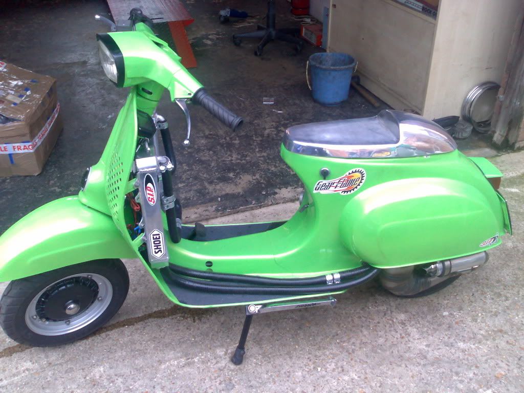

just thought id throw up some pics of ya scoot with the sexy ally seat on!!
That is sexy.

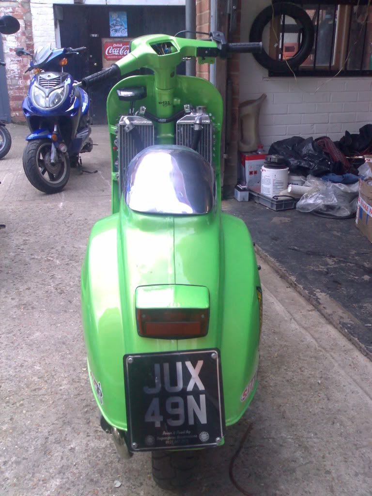

Just stuck on my Quattrini Water pump.
Looks mad as f@@k I think its gonna be either love it or hate it . . . . . . . . Im not sure just yet :lol: :lol: :lol:
I tested it earlier and it does the job so Im happy there, I just need to plumb it in now :D

will the door go on or are you doing away with it?
Wayne Miller
Posts: 345
Location: Rothwell, Northants
RICSPEED wrote:will the door go on or are you doing away with it?
The door wont fit now so its staying off, gonna trim the side panel too me thinks as Im gonna have a go at respraying the scooter myself over winter ha ha ha
