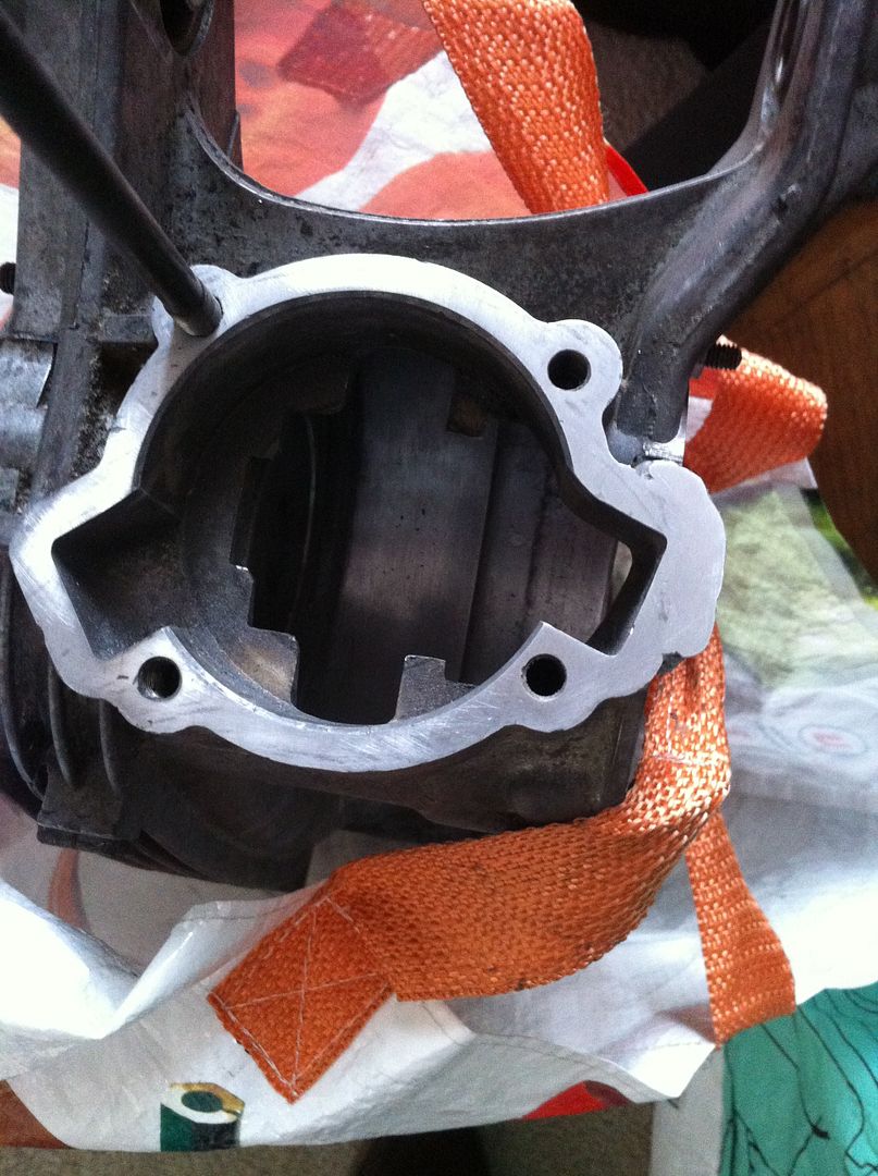

I'm waiting for new parts to come. 3mm packer, new head, batch of head gaskets...
I need the packer to start the case job. I'll start the slight inclination from the packer cos the case flywheel side transfer is tapered reducing the seal surface. Am I clear?? :?:

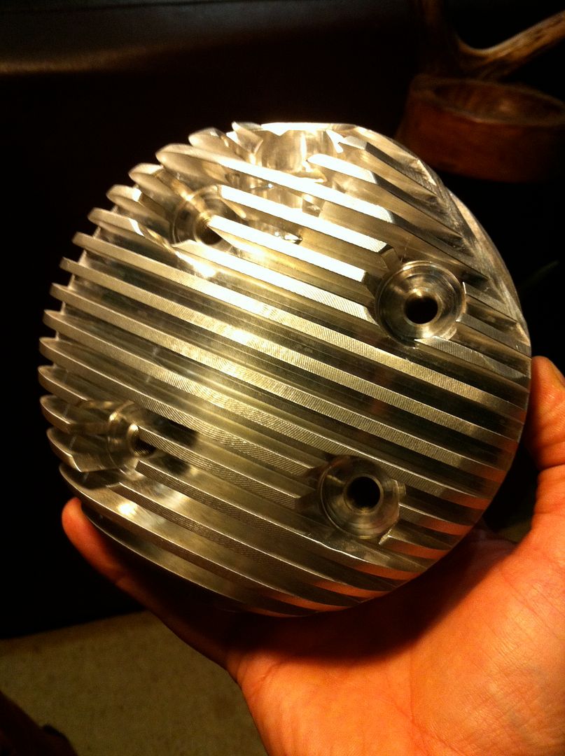

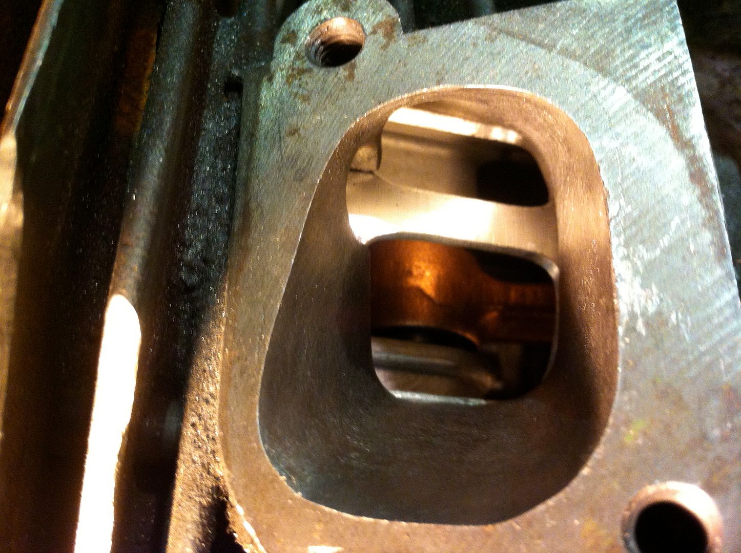

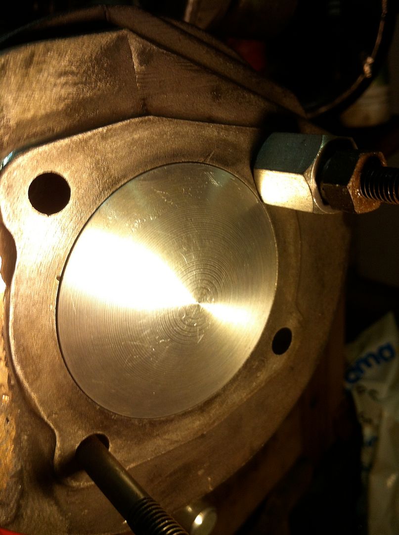

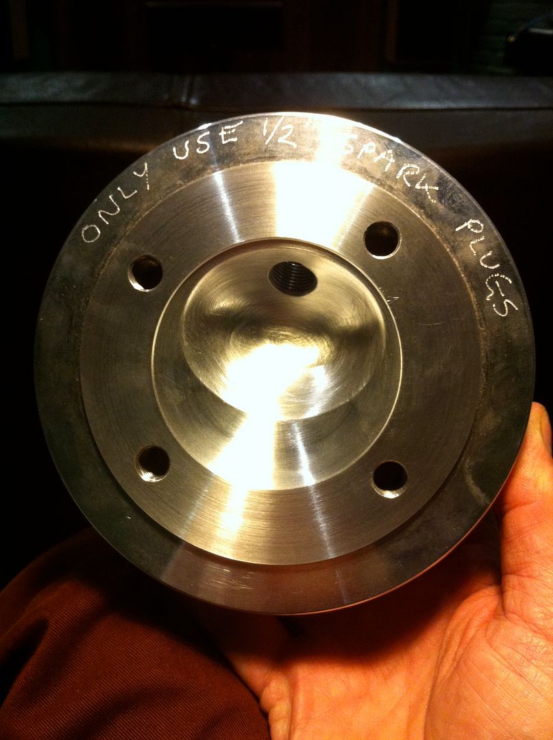

Back to the o-tuning stuff:
Mark Br. did me a very nice 68 mm cnc head with a 1mm recess. A much more matching head than the one I ordered a bit too fast weeks ago....

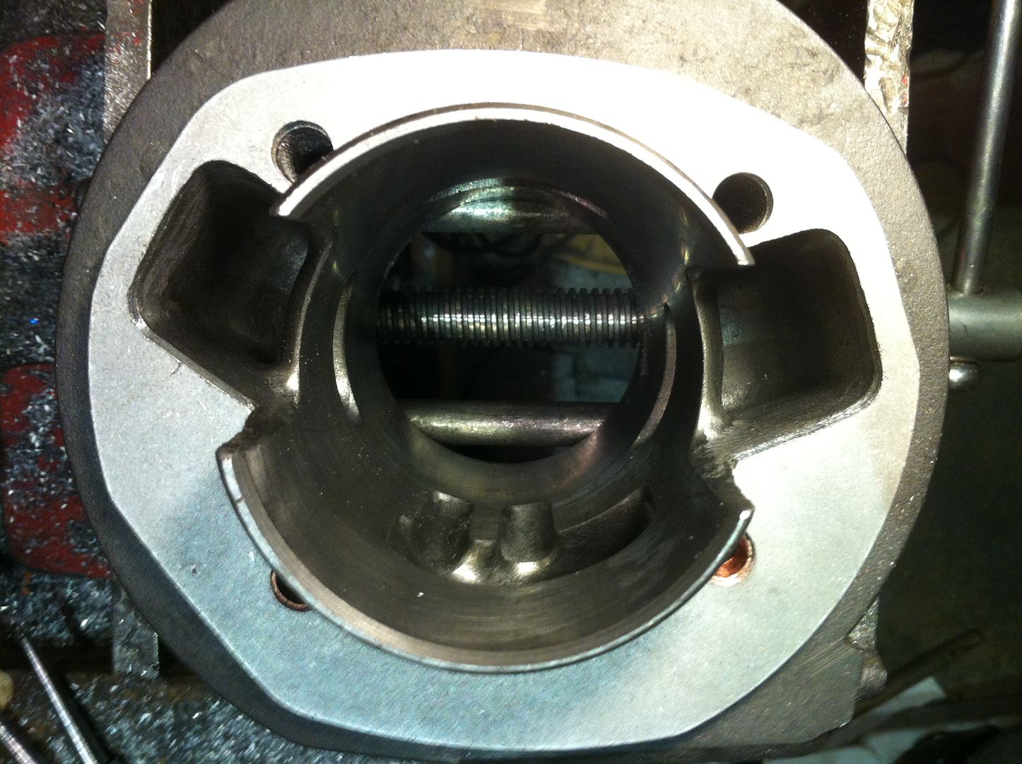

with a 3mm base packer piston at TDC is 0,5mm out :
inlet:

packer cut:

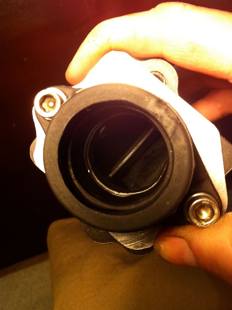

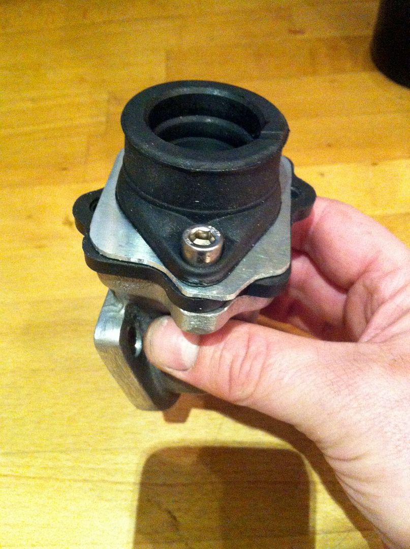

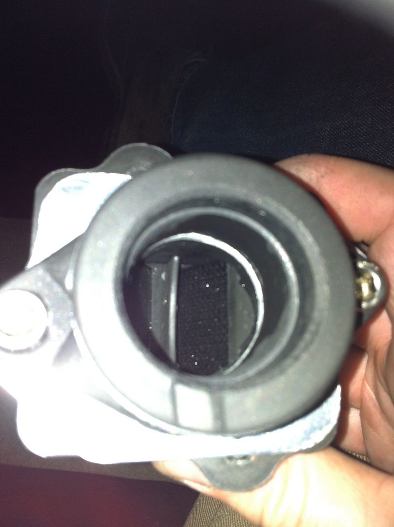

back to the lth reed.
cut a 1,5 mm packer to secure manifold seal pad.
Size matters!

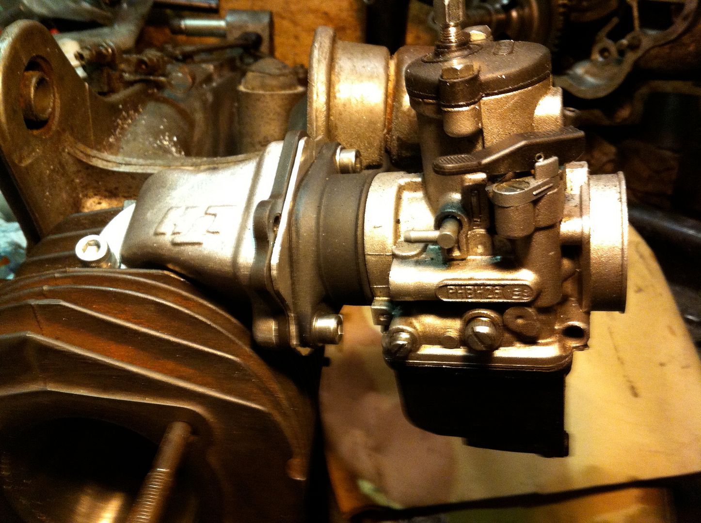

full throttle:
Size matters!
fastfrog
Posts: 412
Location: Paris, Taxes
manifold reshaped to match a dello PHBH. ghee! a real pain in the arch.... :evil:
